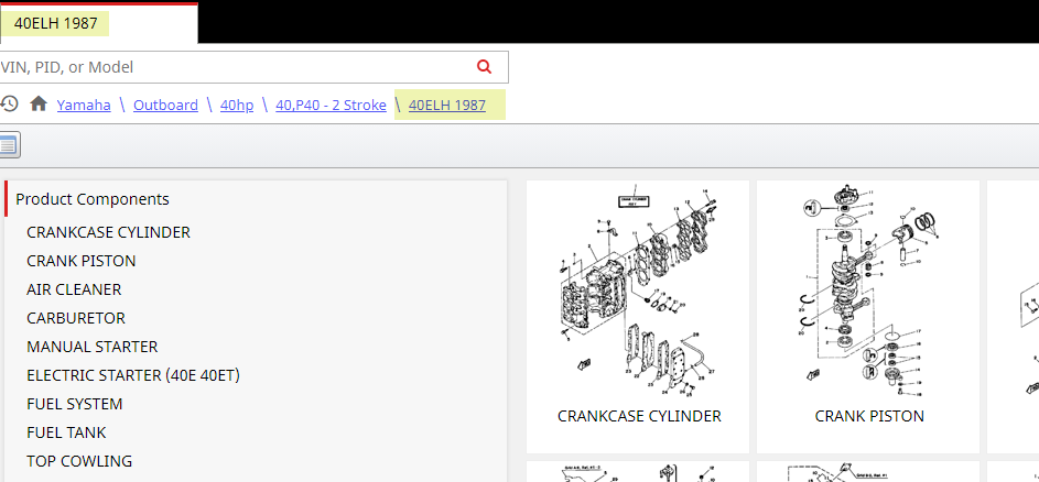

Or a tough journey to the Yamaha USA parts catalogs to see that a 40ELH model is from 1987.
