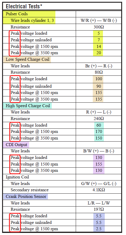

Thanks. I only did the CDI readings because I thought I might as well, wasn't sure about it anyway. The main point was the other readings, all those coils.

I was hoping someone might be able to confirm some of my coil readings were good or bad, and lead me in some direction towards something to try replacing!

I took readings a few days ago using Boscoe's chart. I will show them below.
Today I took readings again. And again the charge coil resistance tests showed odd results. 22,000 ohms. Yet the engine did spark.
I connected fuel, ran engine for 10 minutes, no failures. Totally stumped, i checked resistance again on charge coil and got 74 ohms which is almost bang on what the Yam service manual says it should be.
I have no clue where to go from here. I have it booked in with a Yam agent but really can't afford to pay someone if they will only repeat what I have already done and come to the same conclusion, i.e. none!!
I daren't take the boat out but if i can't replicate the fault I guess one day I will have to pluck up the courage. No more boat for a while, sorry kids!
I'd love any more ideas but I don't think there are any. My most recent readings (before today's) are below just because I may as well! Thanks to everyone who chimed in to help.
