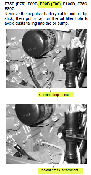

Here is the hook up point for an earlier model Yamaha F90. See if your motor has a similar connection point somewhere on it. If you can't find it, that is what the dealer is for.

Thanks for the photos, but my configuration seems different. I will look and see if I can find the water jacket plumbing from your photo.

Clearly you have a different block.
Your model has provisions for an optional speed sensor and optional pressure sensor. The pressure sensor wiring connector has three wires going to it. Blue/black, black and orange. See if you can find that connector. Should have the letter W on the wiring just above the connector.

Thank you for the plug information, I will look for the plug with the 3 wires. My current gauge only has 2 wires on the sending unit. Do I need a new gauge? The Yamaha rigging guide does not address a temp gauge for my motor, not that I could find.

The three wire connector is so that pressure data can be fed to a Yamaha digital gauge. When an optional sensor is installed. You are not going to be using the connector. I only pointed it out because the sensor to which the connector is connected is plumbed to a port on the block. The same port that you will be using to get water pressure.
