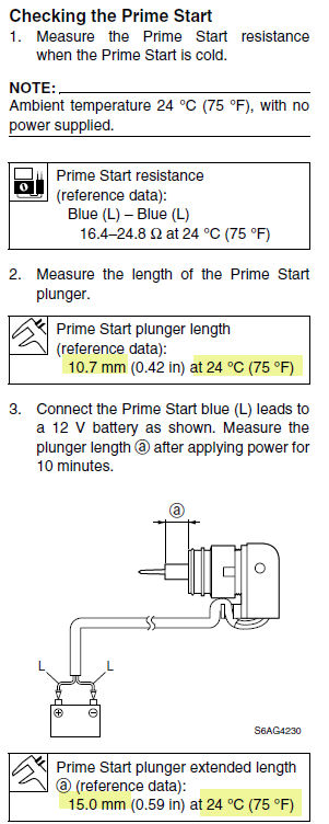

Cold for me is in the 30's as I am in Seattle. I was thinking of pulling the prime start and testing how much travel is in the arm & how long it takes. Does anyone have any exact numbers in travel over time for this? I can't seem to find anything on that.

Travel distance is available. I have not seen travel time published. Time should not matter. The longer the time for the pin to move the longer the motor will be running a bit on the rich side. Which is what is needed to help start a cold motor.
