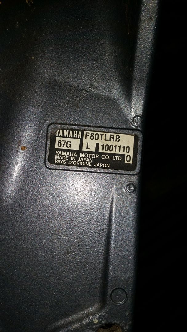

All the info i have at the moment.
I do have a 2 stroke 1996 70 yamaha lower unit lying around
The 4 stroke tag
99yam40
Sep 7, 2008
9,380
motor model # is F80 TLRB
post it any time asking about the motor.
the B says it is a 2003
Look for what motors use the same lower unit # [h=1]67F-45300-10-4D[/h]
igotit
Oct 30, 2015
134
Ive tried that part number on google,that part number is for 75-100 4 stroke motors only.
So i guess i got my answer.
