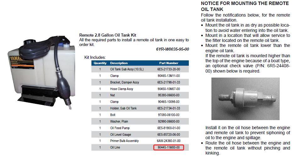

So it looks like I'm going to have to put my remote oil tank for my Yamaha 130 v4 in my center console and run a filling hose from a deck fill cap cut into the side of the console. Boat is a 1997 wellcraft 190ccf
I know the remote tank harness is long enough but what to use for the hose from the tank to the motor. Figure on 10 to 12 feet or so length. Looking for a long term install so quality matters. If someone can tell me the size of the tubing to use to go from tank to motor. Thanks

As well as size I would think that the material type of the hose might be as important.

Did your new tank come with an oil hose? If an extension is needed why not measure the size of the hose you already have? Then buy an extension piece if necessary.

Hi my used tank did not come with the hose.
