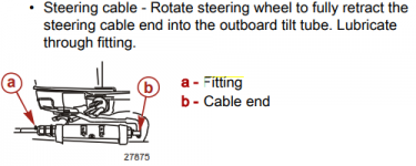

My grease gun does not seem to fit the zerks on my Optimax (its 1/8npt nozzle/coupler is too small so grease goes everywhere except into the fitting). What am I missing? Sorry for such a simple question, but never have had this problem on my John Deere tractor, etc. Does Mercury use a different size grease gun? Thanks

STOP...Those are the bleeder/purge fittings for hydraulic steering
So, a blessing to have not pumped grease into it I guess :) I thought I was following the directions in the attached picture. Is the picture for mechanical steering while the fitting is actually for hydraulic steering? This is the first boat I have had with hydraulic steering (vs manual). Also, then is the only lubrication zerk for the tilt?
