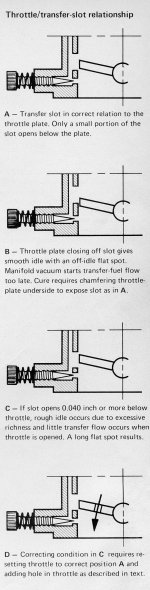

Questions about the set up of a Holley 4160 on a 4.3 V6
Get the primary transfer slot set square. Since your 4160 secondary slots are up high, this is just a 2-screw idle mix carb. Get the...
When the Primary plates are in the correct location relative to the Transfer Slots, the Secondary Plate can be adjusted to attain the...
The carb & manifold don’t have any vacuum ports so I have to use my dwell tachometer. I know about making the primary transfer slot...

replied to the thread
Once you get the slots squared up. You will need a vacuum gauge to set mix. Should be about 3/4-7/8 turn out
Flip the carb over. The secondary screw is underneath. Make sure the transfer slots are both square on the revealed part
