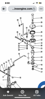

Not sure if i should keep this in this thread, or start a new one.
Im reassembling motor. Right now im working on the throttle linkage. I have all the parts and have assembled them in the order that is shown in the parts page. I cant find any torque specs for this section. The mounting bolt(#25) into mounting nut(#27) is the main thing im unsure of. If i snug the nut up the linkage becomes way too stiff. #27 is a self locking nut so i am assuming you just tighten it enough so there isn't too much slop. How much resistance should i have when i try to move the linkage attached to trigger and throttle? I can't find any info and I've never done this before
There is also a little vertical play between #19 and 22. I am thinking this is normal as it doesnt seem to impede the linkage movement and i cant find a way to change it, but wanted to check on that as well
