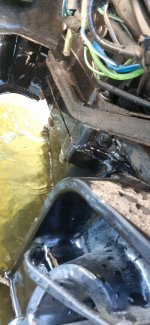

Looks to me like the fuel line in behind this "cam" could be pinched off when the cam goes full travel...its all we could find so far...your thoughts,??

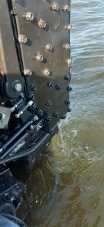

UPDATE.....we have found water from a poor sealing gasket,leaking from the large side plate that has all the bolts through it..not sure what that cover plate is called.
But...would water leaking from a gasket cause all these issues above?

Leaking from bottom

Also...water coming from front portion of engine..but only happens on the lake..not with muffs...you can see the water flowing over the one bolt head in photo
