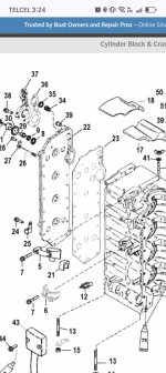

lgaytan
Jul 15, 2015
223
Number 22 and 23 in this diagram right?

jimmbo
May 24, 2004
14,271
If the Insulation on the Plug Wires is weak, and there a path to ground, water could be a conductor
