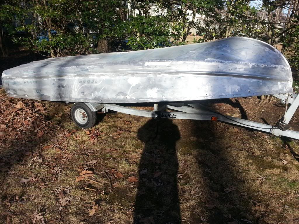

Got it all cleaned up, gtn close to being able to coat it. Dreading doing the inside lol
