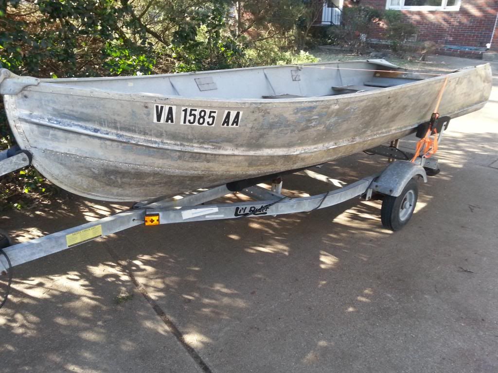

That trailer is just a little short for that boat, isn't it Luke?
Lukelona
Mar 9, 2013
449
Re: 14' V-hull conversion build, shoot me your ideas & thoughts!
yea jig, but I have the winch post way back for my 12' tinny. I can move it forward about 2' and should work ok.

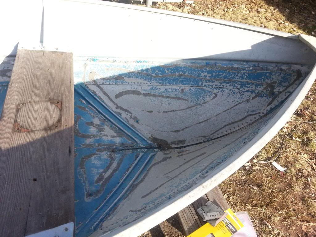

Lukelona
Mar 9, 2013
449
URL=http://s1143.photobucket.com/user/LUKELONA/media/Mobile%20Uploads/20140113_144027-1.jpg.html]
[/URL]
This is the front area, this is what im trying to figure out how to frame.
I'm not sure how I'd make it sturdy in the very front point...
