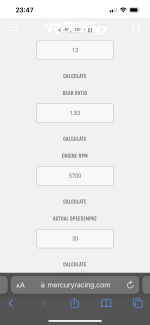

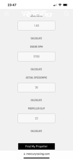

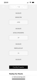

So just had a wee play with your numbers suggested above, with the 30 mph…5700rpm. Came out at 22% slip for me…assuming it’s the 1.83 gear ratio and 13” prop. Defo worth another run out to double check the data.

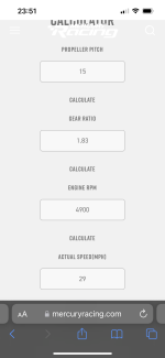

Here is what I got for the 15”. This and the above at 20% ish slip…might even be the norm for a pontoon perhaps. Either way…there is definitely a fair bit of variation or uncertainty around the numbers perhaps.

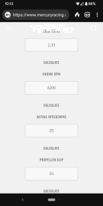

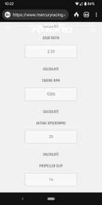

Guys I have a big foot. 2.33 gear ratio. Thought I put that in original post but I guess not.
I am in NH and unfortunately I don't think I will be able to get back out until spring. If you all think my numbers are wrong then you are saying that vessel view is giving me bad data. I haven't looked yet but anyone know where to call to question that?
Miked3
Aug 26, 2022
42

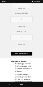

Sorry the 14 slip got cut off. Here it is. Run all your numbers with the correct gear ratio please.
