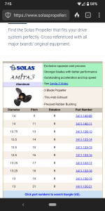

1" pitch changes listed below on the Solas site for my motor. The 13 and 14 are the last two I have been testing on that list. Gear ratio is most likely playing one of the biggest parts in this endeavor.

Boat- 2014 Lund Fury 1625 XL
Motor- 2014 Mercury 60hp 4 stroke elpt Command Thrust 15 spline, 2.33 gear
Original Prop- SPITFIRE PONTOON (13.8 X 13") MERCURY RH PROPELLER, 48-8M8026570 - 4 blade - 25mph @5500rpm
Hustler 3 blade 14 x 13- 25mph @6150-6200rpm hitting rev limiter.
Hustler 3 blade 13.75 x 15- 29mph@4800rpm
*Moved motor up 1 hole*
Solas Amita3 13 pitch is 29.5mph @6150-6200rpm.
Solas Amita3 14 pitch is 30.5mph @5350rpm.
