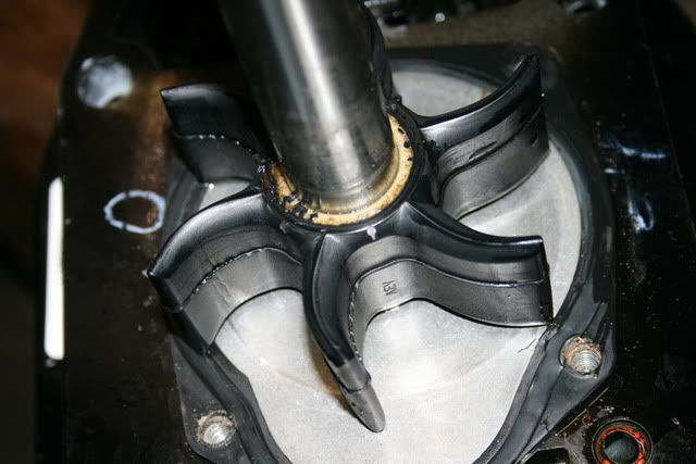

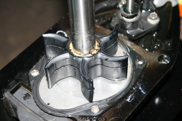

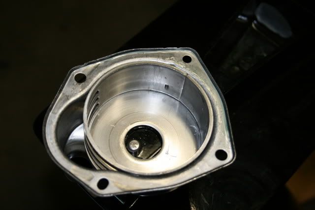

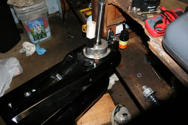

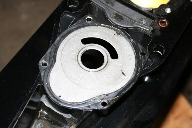

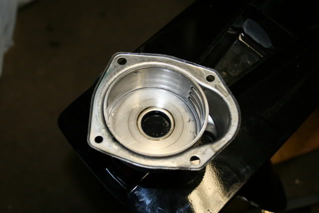

And there they are:
This is what I saw when I removed the housing:
And finally after putting it all back together:
As far as I can tell the upper seal on the impeller was burned up but otherwise it looked pretty good. I'm not sure whether or not it was necessary to replace this season or not, but I'm glad that I know for certain that I have a good impeller. What do you guys think about this, did I replace a good impeller?
The job took me two and a half hours from start to finish with this newbie taking his time at every step.
Tomorrow I'll have to go and connect the vent tube at the front end of the outdrive that I forgot about until now, can anyone explain exactly what this thing does?

I honestly think that impeller looked just fine. Keep as a spare in case you melt one. It is good to get you back in the water if you can;t get one fast.

TomB985,
Thanks for the pictures. The impeller looks good indeed. Do you think the seal was burned by running dry?
I tested mine in the water today and after running the boat for several hrs, including some water skiing runs, I can tell that no overheating whatsoever. I guess 15 seconds is not enough to ruin an impeller.

Thanks for the feedback and pictures. The impeller looks good indeed. Do you think the seal was burned by running dry?
I don't think so, the seal looked undamaged and pliable when I removed it.
Knowing what I know now I shouldn't have replaced it, but the thought of a disintegrating impeller cooking a brand new engine would have driven me crazy if I didn't make sure. A new engine would set me back over $5,000, and despite the fact that it's still under factory warranty they wouldn't cover a repair if they found a trashed impeller from water starvation.
We had it in the water today for about an hour and it performed flawlessly. Doesn't appear that I screwed it up, but I honestly am not sure how I'd know if I did. Even if one of those gaskets leaked a little it would still move lots of water, so could anything be damaged if this were to happen?

Your impeller is defective, and it needed replaced. The impeller vanes should straight out within 10 minutes, not stay bent over as in your picture. The pumps work because the impeleller vanes bend and open back up. That's how the pumps work.
Since yours don't straighten out , at higher rpm you are going to get less flow.
That is why you didn't have problems until 3500 rpm.
Just because an impeller doesn't have cracks or the blades are broken off, doesn't mean it's a good impeller. That one isn't even a good spare.

I stand corrected. I went back and looked at the old impeller I had saved from a replacement I did several years ago and the vanes were mostly straight indeed. That old impeller also had a couple of short dry runs. I guess I forgot about the shape difference.
