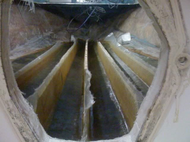

Progress so good it hurts! Seriously, my legs are still killing me from doing all 6 stringer glasses on Saturday. It took 4 trips to the store for more rollers, a new handle because the walmart rollers wouldnt fit my lowes handle and it was 11pm, cheap walmart nitrile gloves that weren't worth the bag they were in, Lowes for new respirator cartridges, and HF for the good gloves:rolleyes:.
Got the glass cutout while I was bored Friday night, heres my soon to be floor template foam acting as a pretty good layout table!
Anyways, did the outboard 2 sections on both sides at once, and then back in that night for the two center sections. I'm done glassing friggin stringers!

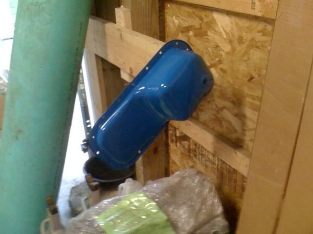

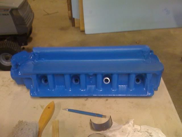

Sunday was a slow day, spent the morning with my girlfriend before she went to work, and was to whipped from the glasswork to muster up the courage to grind the excess stinger glass. Instead I put the scotchbrite on the die grinder and did some cleaning. Spent about an hour on the oil pan that was thick with grime and rust. Heres the result after 3 coats of primer and 3 of Ford Blue engine enamel.

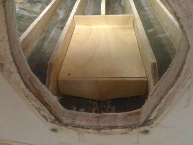

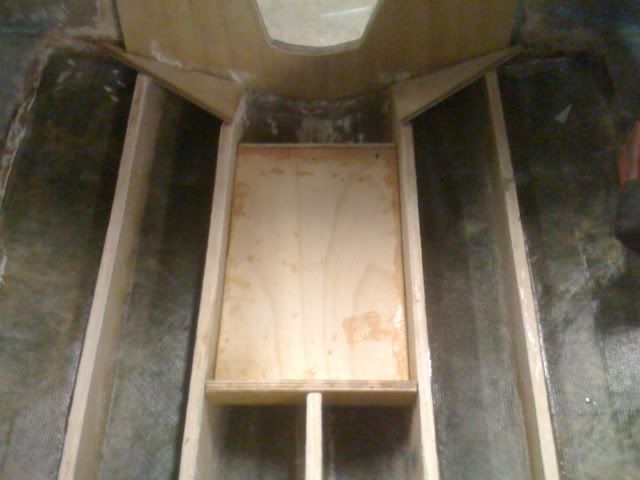

Started by making the motorwell out of 3/4 aruco leftover from the transom:
Used some spare 1/2" blue foam for some templates for the angle plates:
Then got them glassed with 1708 on the bottom:
PB'ed them in place. They will be tabbed/glassed once the floor is in:

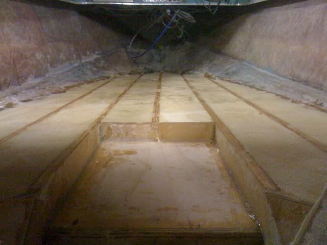

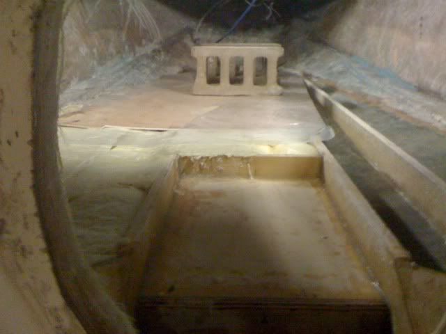

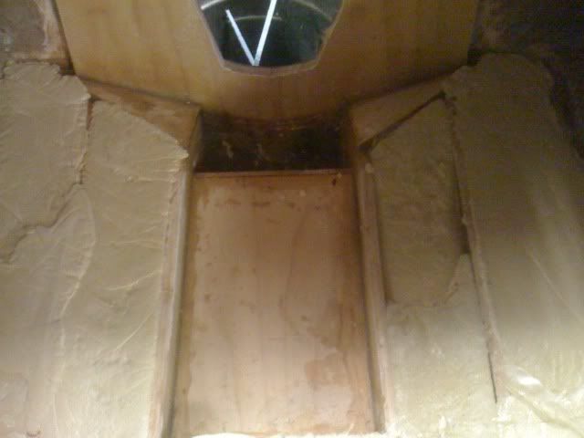

Then it was time for the foam! I went with 2lb USComposites pour-in foam. I decided to just pour it in , without using Bob's method for making it removable. I figure it will still last quite awhile as long as I am a bow-up/plug-out boatowner. Went thru about 50 party cups to do it all. Doing it again I would use quart sized paper cups to lessen waste and go a bit faster.
Here it is in process, about half done:
And when I left it for the night, about 10pm:
Monday AM I hit it all with my new 7" rotary sander with 60grit to level and smooth. Then I filled the low spots and resanded. Here is the finished product, after a seal coat of resin rolled on:

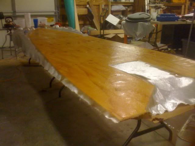

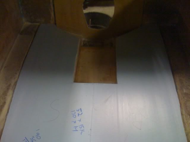

While the seal coat of resin was on, it was floor time! Finally! I had made a table of offsets Friday, so I laid it out and made a template in 1/2" blue foam.
This picture made me as happy as I have been in the boat yet!:D It is a good wood floor laid on the foam!
Once I had made both the floor sections, I sliced and routered 1/2 thru each piece for a 6" overlap. I think oop's gave me the idea to do it this way:
Then, once they were sure to fit, I PB'ed the joint and got to glassing! a seal coat, and then 1708 on the whole deck bottom. The top will be done once it is in the boat to tie it in. A one of the finished product. About 12' long and 4' wide in the rear section:
I came within 8-12oz of running out of poly!:eek: That's 7gal down, I figure 3 to go, depending on what sort of glasswork any bulkheads and seat boxes require.
