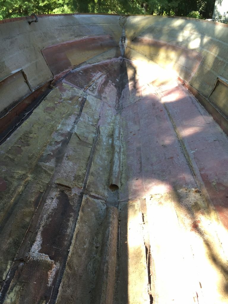

Thank you guys very much for your feedback! I got a grinder today SDS and a wire cup that you sugested in the list WOG and it destroyed the foam which is great. The list you gave me WOG is perfect! Thank you! I made huge progress today and got most of the foam cleared up so that there is just a fine layer I will blow away asap. I will grind down the remaining tabbing and then get the hull sanded down to fresh glass. I was able to seperate the splash well today, and it really did not take much of the transom off but it pulled off the glass covering to reveal the wood. Im not an expert but the wood looks like it is ok. What do you guys think? If it is ok, should I sand it down and re glass it?
I also did what you said to find cracks WOG and discovered two holes I must have made cutting out the stringers. What is the best way to go about filling them? Should I sand the rest of the deck first, or fill the cracks?
Thank you!
Just mark the locations with a Magic Marker and go ahead and prep the hull. Those cuts will be EASY fixes when the time comes. Replace the transom...You're already there!!! Your pics show that it has some delamination already starting.

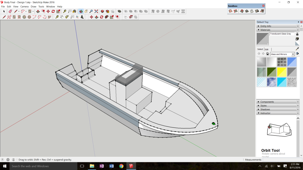

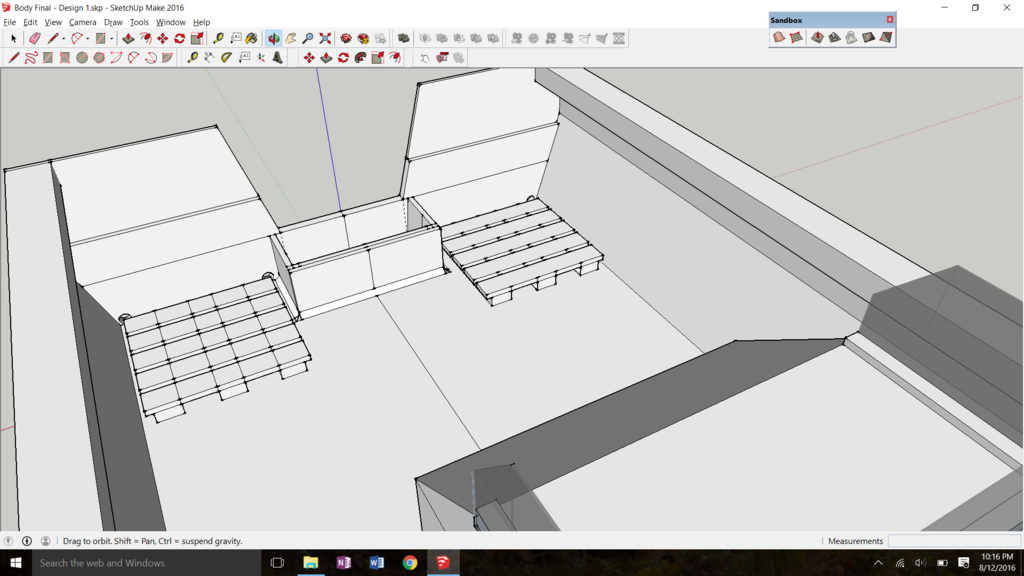

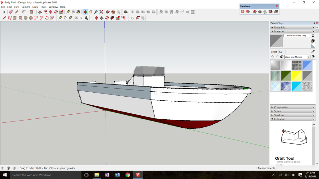

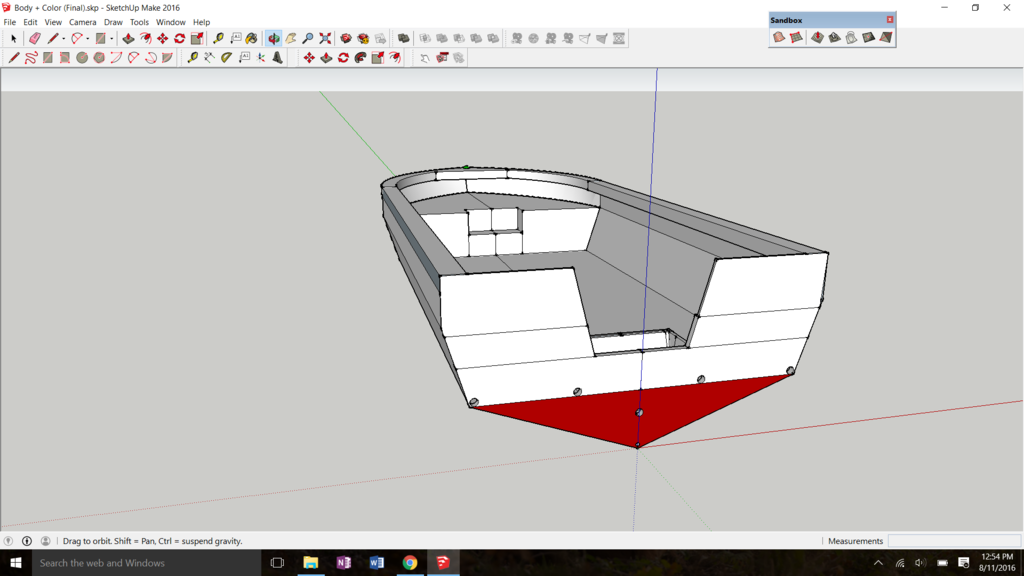

I am back from vacation and have acomplished a few things. I had a lot of down time so I designed my boat using google sketch up so that I can build the deck and features I want and see how it looks. this is what I have so far:

I also have some questions as I move forward. I have completely forgoten to plan for the install of a gas tank. I have a few questions. First, is it better to have an internal tank or external? I have reasearched both and I know that you need vents and all with internal. From what I have seen they sit Between the stringers and are bolted in on the sides with a gap on all sides to prevent them from wearing. My first question is, Which is better? If internal, how big, and how to install.
I want to make sure my boat does not crack or somthing due to poor weigt distribution if I hit a wave or what not. I think there would be space for a big tank under the center console also for a topside tank.

Remember, if you are running a two stroke you need the proper oil/ gas ratio. So the internal tank, although will hold more gas, will need the proper mix ratio. Internal tanks are usually larger so fill ups are less frequent. It depends if you are running on an ocean or lake. No matter what you decide, try to have the tanks as forward as you can. External tank under the seat or console. An internal tank inder the deck ( floor) as far forward as you can. Perhaps under the console. Good looking boat.

I'll put in a plug for plastic (let's say non-metal) portable tanks. Permanent tanks carry with them all kinds of issues for fuel storage and fuel contamination. "Portable" doesn't mean the small hand-held 6 gal jobs, although it can. You can get a number of sizes and configurations to suit your needs, but IMO they will be less trouble for keeping a good fuel supply both during the season and between seasons.

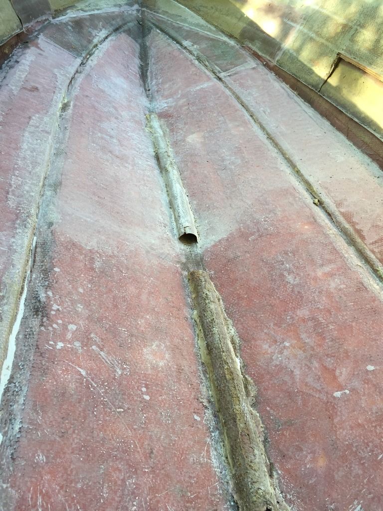

Update for today:
I did a lot of work today sanding and cutting the old tabbing on the stern. Its starting to look clean!

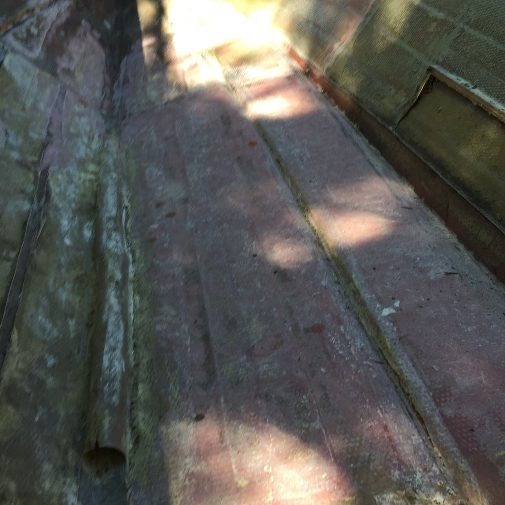

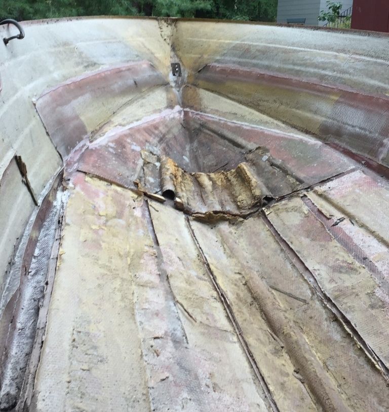

I am wondering what do do about this thing on the floor. Its fiberglass tubes that have foam on them. I would just leave it but when I got the boat it had no stringers after the flat part of the boat ended. So in other words, the stern had non. I dont know if that is customary or what, but I wanted to put stringers in that are a little taller than the ones going across the middle and bow, so that I can have a kind of elevated platform in the front (like the one in my cad renderings above). In order to put stringers in, I think I have to get rid of it. Do you guys know what it is?
Thanks!

Those tubes are to stiffen the hull to keep it from flexing. If you replace them with a longer stringer it should be ok. Just don't remove them without adding something to support the hull.
Marine grade plywood wood be the "best" choice but it is very expensive. A lot of folks use good grade exterior plywood instead, probably about half the cost. Just make sure its exterior grade because it has waterproof glue.

I agree with Sds .... Tubes are stiffeners ... They may have had wires running through them also .. A raceway from your cc to the front and back of the boat will aid in keeping thing tidy ... As said if you run the stringers all the way forward it should be fine to remove ... You going to pour in new foam ?

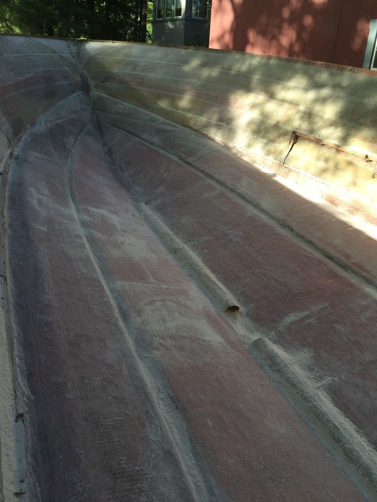

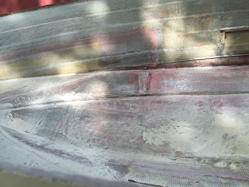

Today was pretty awful haha! It was hot and I started sanding with the grinder. Im not sure if I have sanded the middle section enough. I went at it for a good 4 hours with the grinder. When I tried to use my sander to finish it up, it didnt seem to be making any difference. I am wondering, Do I have to grind down untill I see 100% clean red glass, or have I sanded the area I worked on enough? There is a really tough film of dirty looking glass that is so hard to get off.
Also, Im wondering how yall recomend to stand in the boat when sanding, I try to stand right in the center to avoid putting stress on the outside of the hull.

Have you put any support under the hull ?
You can get the pink or blue foam sheets and cut to fit under the deck if you want .. They will not absorb water ..

When I was grinding the hull I found it easier to lay or sit in it. Anyway you do it, its the most miserable part of the job, especially when its hot out. Keep up the good work and it will be done before you know it
I tried to grind it down to clean glass as much as possible, at least where I was tabbing in the stringers. Some of the grim will wash off with acetone.

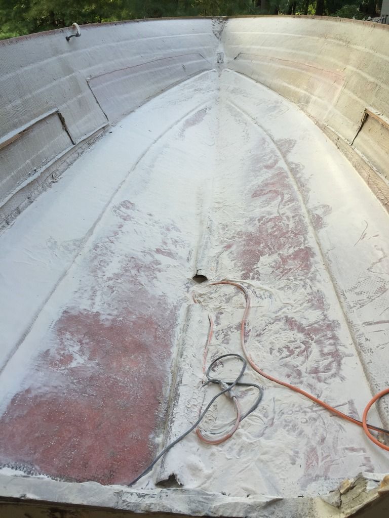

Thank you Sphelps, Mabey I will use those sheets then! I just dont ever want to have to take the boat apart again, so a non absorbent foam would be great. WOG that thread is great, I will try those in the future. Today and yesterday I just ground all day and then gently swept the dust to the back of the boat and used a dust pan and brush to scoop it into a trash bag. Worked well enough and due to the fact that there was no wind most of it was contained. SDS, I am going to go to Lowes and see what they have to offer, I think home depot would be the best option as they have a bigger selection. I have been grindng down to clean glass now. That seams like the right way to go! At least around where the tabbing will be.
Today was wild. Worked the whole day and I think I made a good dent! I will do more grinding the day after tomorow. My hands are killing and I think its time for a break. I wa looking at the boat today thinking about how awful it looked to start and now how I think it has hope. For sure would not have gotten anywhere without the help you guys have offered. Huge thanks. I am supper excited to get building.
I ground the center of the hull on both sides today down to clean glass, and in two days I will do the outside.
