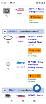

This is weird and I think it may be incorrect but your part number comes up as "impeller spacer"

This particular o-ring is used in many applications including motors in 2011 and even newer.----I should look this # up in an " old time paper " parts book.

I saw that picture labeled impellar spacer on marine.com too and it added to my confusion. I do appreciate the help if someone knows the correct part number for that O ring.

302035 (0302035) is the correct part number for that o-ring. The same o-ring is used on the impeller housing spacer on various motors, explaining the description.
Bottom line is, the e-bay seller sent you the wrong o-ring, improperly labeled 302035.
