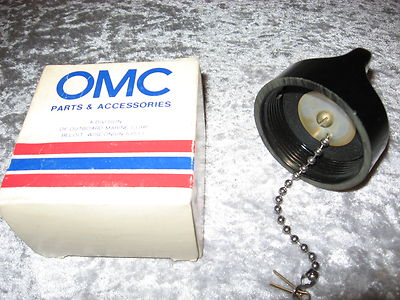

Thanks for the replies. ill try both and see how it runs. I know the factory needle settings and had it before. ill reapply those to double check. the main problem is keeping the fuel pulling through the carb. any suggestions for a replacement on the pressure tank cap gasket? if it had one or not i do not know. should the hole in the side of the cap be covered? it is a dual line omc like in this file. mine just has the cap and nothing else... i listened for fuel draining back into the tank but didnt hear anything. Again thanks for the help. my kids will surely be grateful. they love being on my little jonboat

The tank needs to be 100% tight. The cap DOES have a gasket. If the primer leaks it needs a new o-ring as well.
There are also o-rings in the plug as well. Might also replace the 2-line hose if that hasn't been done.
39,248
The hole in the cap is there to release the pressure in a controlled manner when you loosen the cap.----It should not be covered.

Ok so far I've reseatted the idle and high speed. The gas tank does hiss a bit right after the engine shuts off. I replaced the hoses to all connections two weeks ago. I guess my next step is figuring out if the tank cap gasket is necessary... Currently have a sturdy piece of cut cardboard as I didn't want the tank or connections blowing apart. Also is the pressure bulb o ring necessary as well? The only thing I remember without taking it back apart is the plate spring and diaphragm that it rested on. No o ring on the pressuring bulb.

I didn't take any time to research the cap gasket but you can get a brand new cap:
Personally, I just fix the cap myself. a small piece of gasket material and a scissors and viola.
