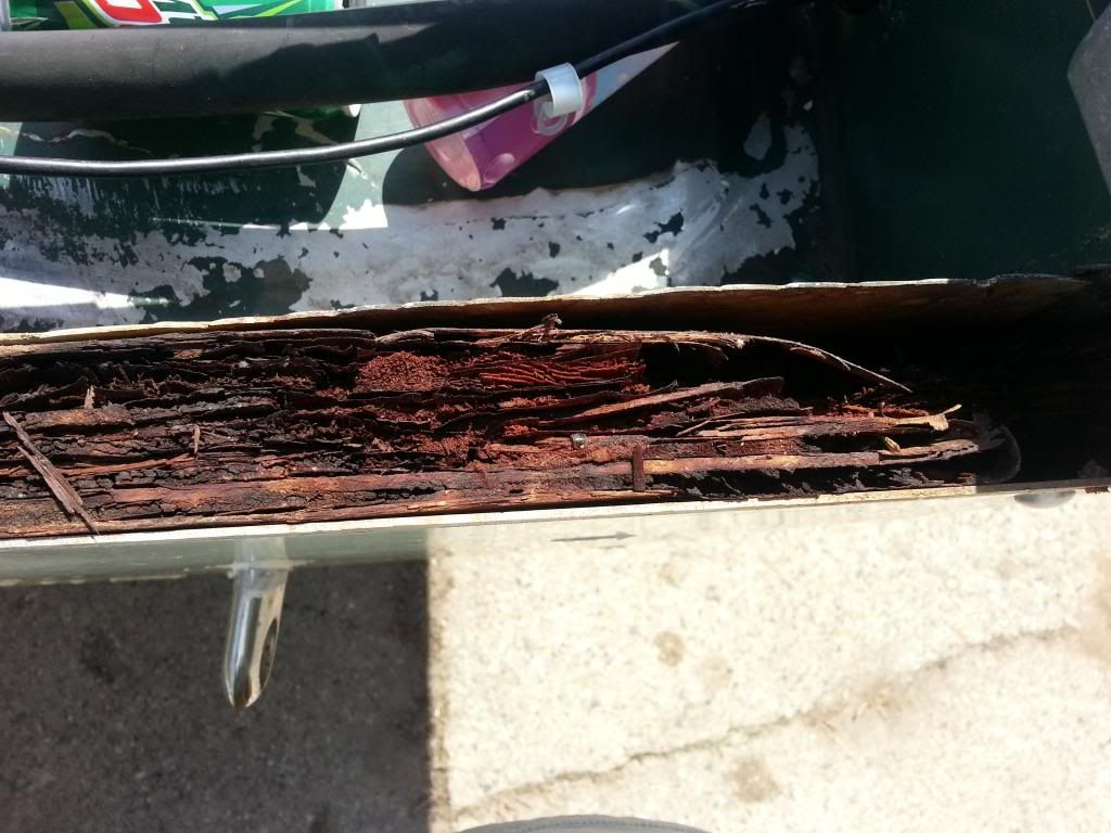

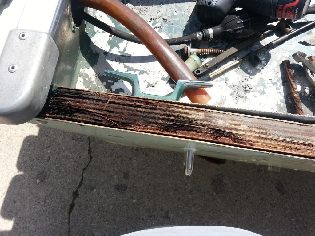

Motor and transom cap off
OK well the motor is off and I've started to rip into the transom. Sun was high and hot today so I had to take a break.
Wood is so rotted that it's compressed in the middle and crushed in the outside top of the aluminum. No biggy, I can bang that flat once the slashwell it out.

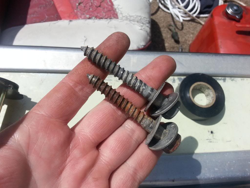

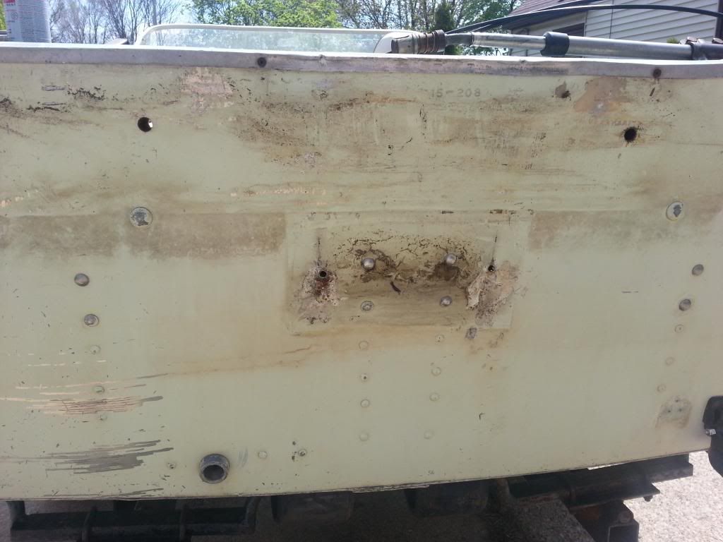

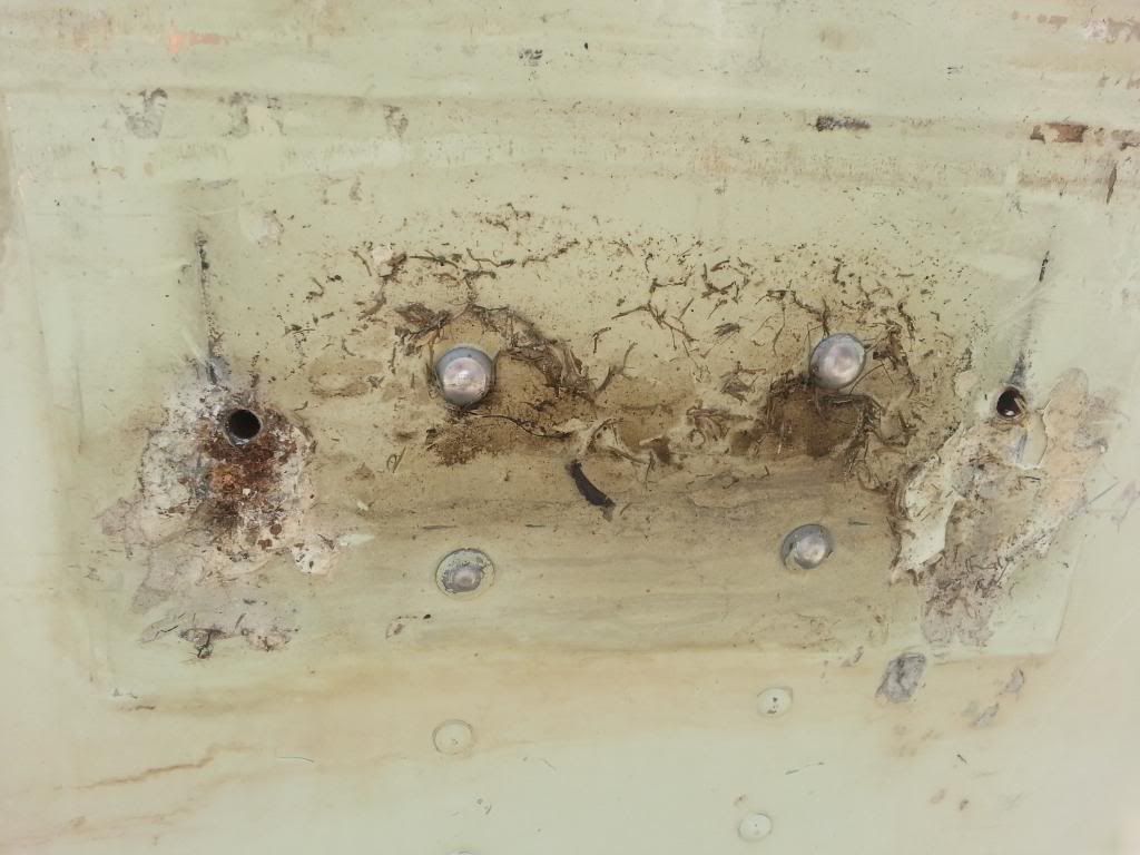

So here is what I found under the wood planks (motor pad) on the outside of the boat.
No real damage, that is all sealant and dirt. Little denting too but again, I can pound that out. Looks like I have two sets of holes. One that was actually used and the other that was filled with some white sealant. Sure they were leaking water.
These were the bolts that were threw the motor mount into inner transom
