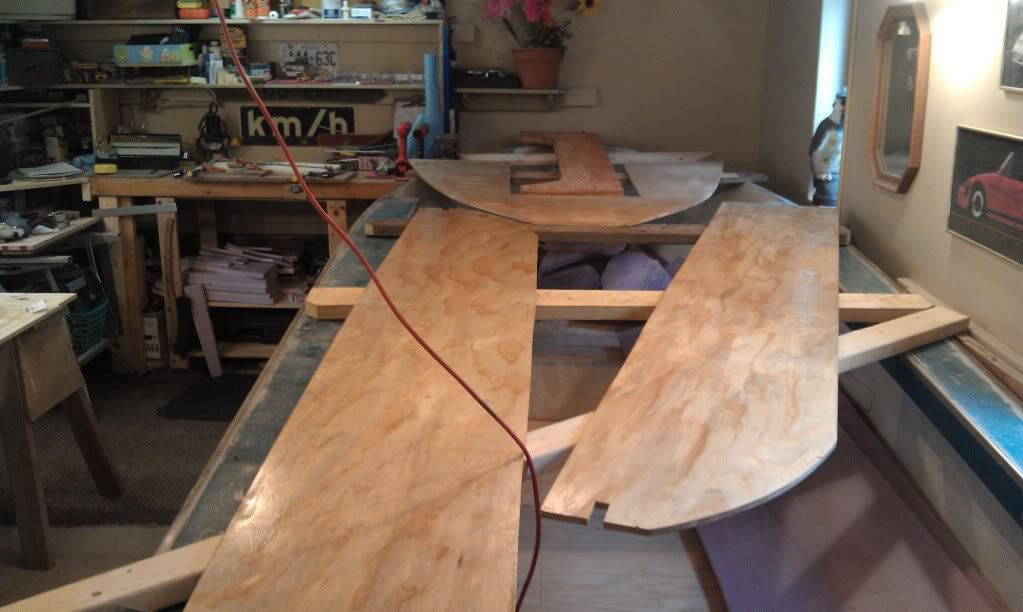

Alrighty.... some progress to report from a land far away....
First got the 3 pieces of the dash face sanded individually, glued and clamped and ready for final sand tomorrow.
Got all the decorative wood pieces that are going in the boat... 2 side pieces, 2 gunwale top side pieces and the piece behind the rear seat all cut, sanded and ready for spar varnish
Got some spar action here:
And some more here...
(Also ahhhem... managed to paint the green on the doll house... but that's not for me.... I've moved on... :D )
It may not seem like much... but like anything, it takes a bit! Got some family stuff tomorrow... but plan on getting the rest of the spar varnish applied to the floor and more coats over the next couple of days since it is much warmer now outside --- close to the freezing mark!!!
Have a great Sat. night folks!!!
Jim

InMotion
Nov 3, 2011
2,080
Re: 1960's Falcon Rebuild (New Title)
Thanks fellas! Little by little!
Got second coat on everything else this morn... and 1st coat on the floor pieces... had to stack em to get all the pieces to dry....
Not all that exciting ... but progress is progress!
