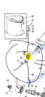

see pic mid-way down the lower housing is a small plate ... remove it to find the link connecting the 2 halves of the shift rod. the rounded ends must be seated inside the link and the bolts locks the 2 rods into one. :)
if you are going to work on oldies you should get the book CHEAP OUTBOARDS by Max Wawrzyniak which explains all this ..

^^like they said. You might open up the clamp just a little with a bladed screwdriver, just to make sure the rod goes fully in place.
