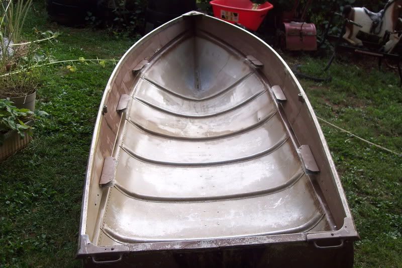

I bought this 12' Sea King V-Hull for $175 from a gentleman who couldn't fish with it anymore. The hull is in good shape. The PO said it leaks a 1/2 cup after 4 hours of fishing. Sounds like a job for Gluvit. Would I apply it on the rivets on the outside of the hull?

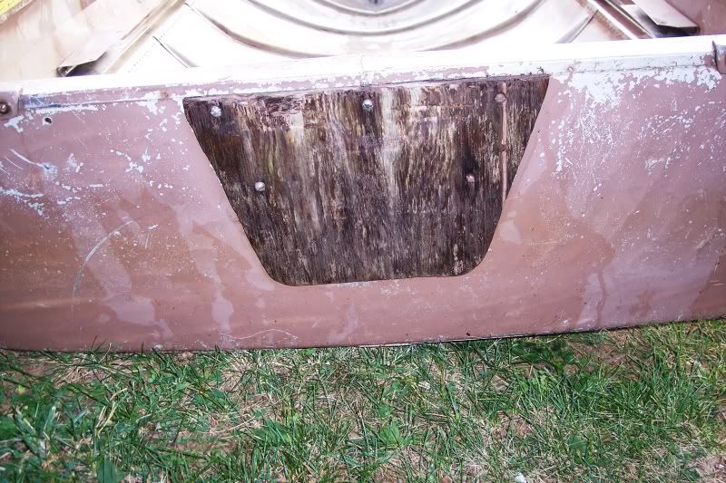

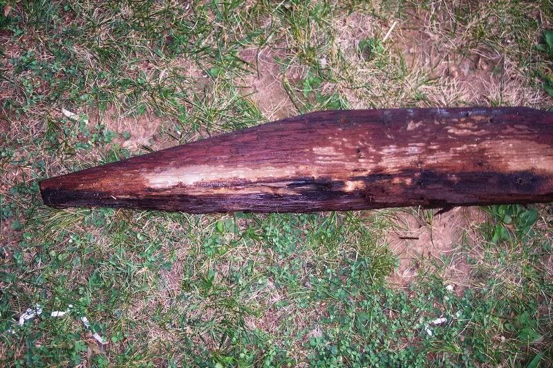

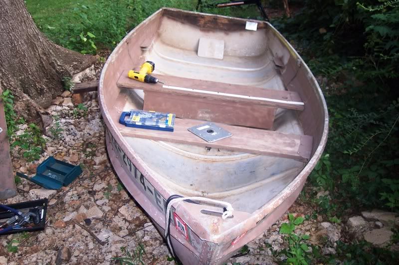

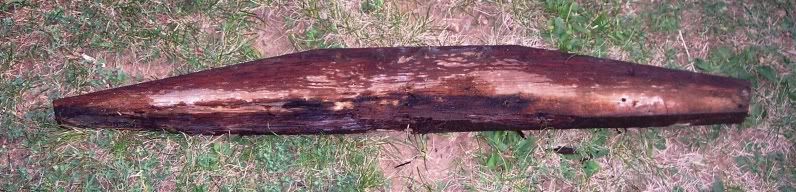

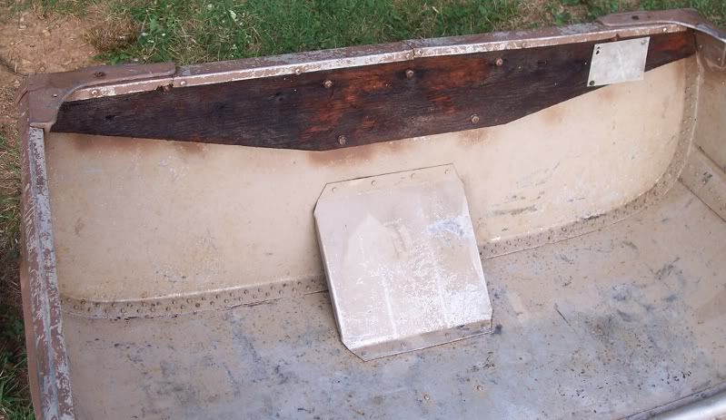

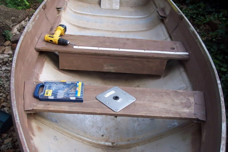

I've removed the seat boards and transom boards. I am replacing the seat boards and the inner tramsom board was rotted, but still useful for a template. I power washed the hull inside and out.

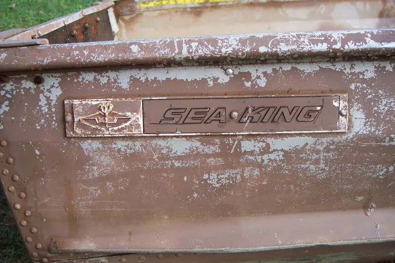

I have to strip the paint. It's not heavily painted; what could I use other than stripper to remove it? I see from reading this forum that I need to use an etching primer and marine paint. What type of wood should I use for the transom board? Not sure about the seat boards either; might want to use a lacquer or waterproof sealer on them for that natural wood look.

Here is a better pic of the Sea King. I forgot to mention that the seats came with the boat; excellent condition. :)

Nice looking rig. Gluvit is typically used on the INSIDE of the boat. You should use a wire brush or a wire wheel on a drill and clean around the rivets as best you can before applying the gluvit. You can use Exterior Grade Plywood for the wood on the seats. Stain it with Epiphanes stain and then use several coats of Epiphanes Marine varnish. It will last for years. The transom should be coated with Polyester resin and a layer of 6 oz cloth on both sides followed with a couple more coats of resin. That will make it last for ever. If you drill holes in the transom for mounting bolts etc... make sure to coat the holes with resin to seal them up and prevent water intrusion. Sand the outside of the hull with a random orbital sander and 80 grit but don't get carried away. Then use a self etching primer and check out Rustoleums Professional Oilbased paint. Lot's of people on here use it to paint their Aluminum boats and have GREAT results.

You have to cover over the Gluvit; paint, decking, whatever. The sunlight will destroy it if it is not covered in some fashion.
Most folks use a high grade exterior ply epoxy coated for the transom. Some fiberglass it too.

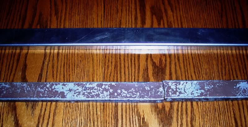

I've had to remove and will replace the aluminum channel/cap that runs along the top of the transom board. It's cracked (broken) in 3 places and will not be wide enough for a 1 1/2" board. The old transom board is 1 1/4" thick. (?) A friend at work can make it for me; if not aluminum then galvanized. Thoughts??

if not aluminum then galvanized. Thoughts??[/QUOTE said:
I don't think aluminum and galvanized metal are comparable. Don't use treated wood for the transom, the chemicals in the treated wood will have a bad reaction with the aluminum boat. Other, more knowledgeable iboaters will chime in to correct me if I'm wrong.

My son and I removed 24 screws from the Sea King tonight. Man, they were rusted. They were holding the front and back seat mounts (for the boards) The PO had moved the front seat back and the back seat forward for more room. Great idea but he used screws and nuts.... I had to cut some off with a hacksaw. The old holes where the mounts were previously located had screws and nuts in them... What a mess.

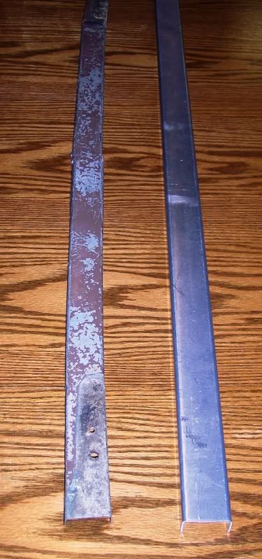

My friend at work made a new aluminum transom cap for me today. He made it 1/4" longer and wide enough inside for a 1 1/2" inch board. He also brought the sides down by 1/4' on each side. He did a great job. :)
I removed the bow cap as well. It also was screwed on with bolts and nuts. Rusted.... I am going to use all new aluminum rivets to replace the screws. It's coming along well. Vacation next week so it will be on hold for a bit....
Here is a pic of the new and old transom caps.

Re: 1962 Sea King Restoration
WOW I can tell you a WHOLE bunch of people would love to have a friend that makes nice transom caps! That is the nicest I have seen ;)
That IS a Friend!!!! Can I borrow Him when I start MY project?????
Yes - he did a great job on the transom cap. I told him he should open a shop. He is a maintenance man and sheet metal mechanic. He is one talented dude.
Question - the inner transom board will be 1 1/2" thick. Should I glue (liquid nails) 2 pieces of marine grade plywood together and cut it to shape or use one piece of some other type of wood - say oak, etc....I like the 2 piece idea.
I just did my transom, with the advise of many here. I used A/C exterior grade and laminated it using poly and glass. I think you could get by with PL adhesive (from Home Depot and such). After I laminated the plywood, then I cut and shaped the blank. I felt it would be easier to cut two rectangles, laminate, and then shape one piece vs. shaping two pieces and then gluing.
The transom should be coated with Polyester resin and a layer of 6 oz cloth on both sides followed with a couple more coats of resin. That will make it last for ever. Pay close attention to the edges of the plywood with the resin and the glasss. If you drill holes in the transom for mounting bolts etc... make sure to coat the holes and the screws and bolts with resin to seal them up and prevent water intrusion.

I haven't updated for a few days..... I have finished sanding the hull and wire brushed all the interior rivets. I cleaned up the front nose piece and rear corner brackets. I took them off the boat. :)
