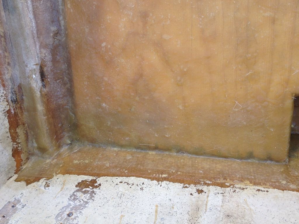

By the way I glassed in the edges of the floor to the hull with three layers of fiberglass. Two layers of matting with one layer of woven sandwiched between them. That should make the floor and the hull bonded very strongly.

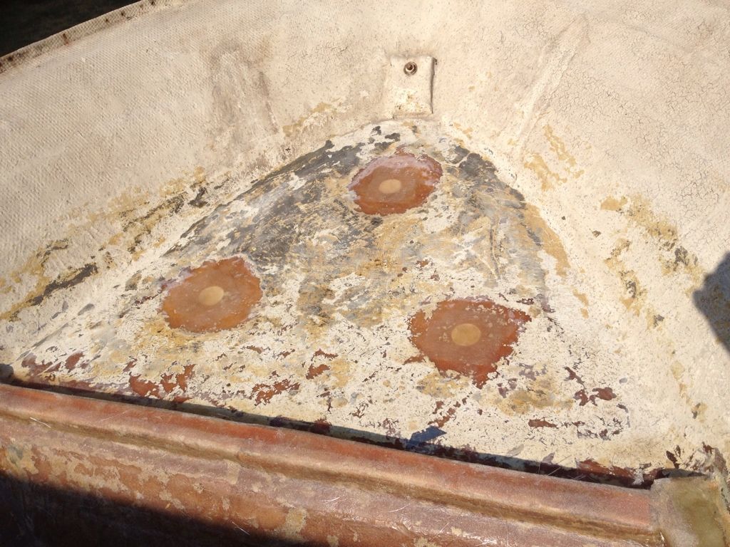

I glassed in 90 percent of the floor tonight but I ran out of both resin and madding and will have to finish the rest tomorrow. All i need to do is put on a second layer about 8 inches wide along one side, one patch on the back, and then glass the back edge into the transim and im done. Well that in the three small holes I drilled into the bow with .

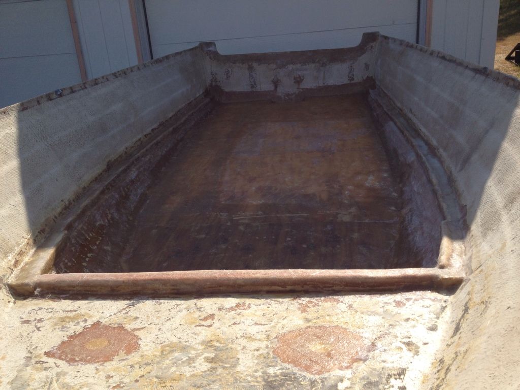

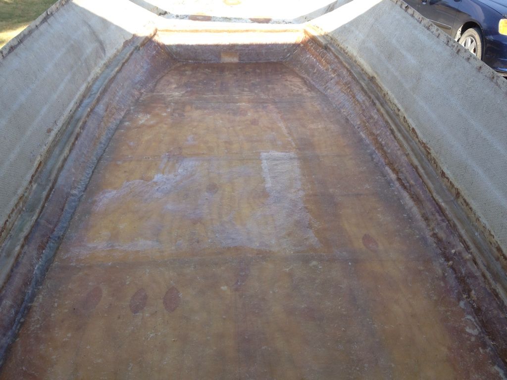

I finally got the floor of the boat completely glassed in. There're two layers of matting on top of the wood deck. I put in a small piece of woven glass between the two layers of matting on the seam between the two boards near the bow. That should prevent any cracking or flexing at the joint. Where the floor meets the transom one side has two layers of matting in a layer of woven but the other side has just two layers of matting because I ran out of woven. I'm pretty confident that the joint between the floor in the transom shouldn't crack or flex. When I started glassing the deck on Tuesday I put plastic bags around my feet and duct taped them to my legs. I was worried about stepping in the resin and getting dirt on the floor from my shoes. it looks funny but it worked. Since the last pieces were all along the side of the floor and near the transom I glassed the last layers by just bending over the boat. Much easier. I'll post pictures tomorrow after it sets up.

Here's pictures of the boat floor roughly glassed in after it dried this morning. Today we are going to flip the boat over and support it with sawhorses and stools under the floor. After the boat bottom is painted we'll flip it back over and I'll roughly sand the floor and fill any blemishes and then get it ready to paint.

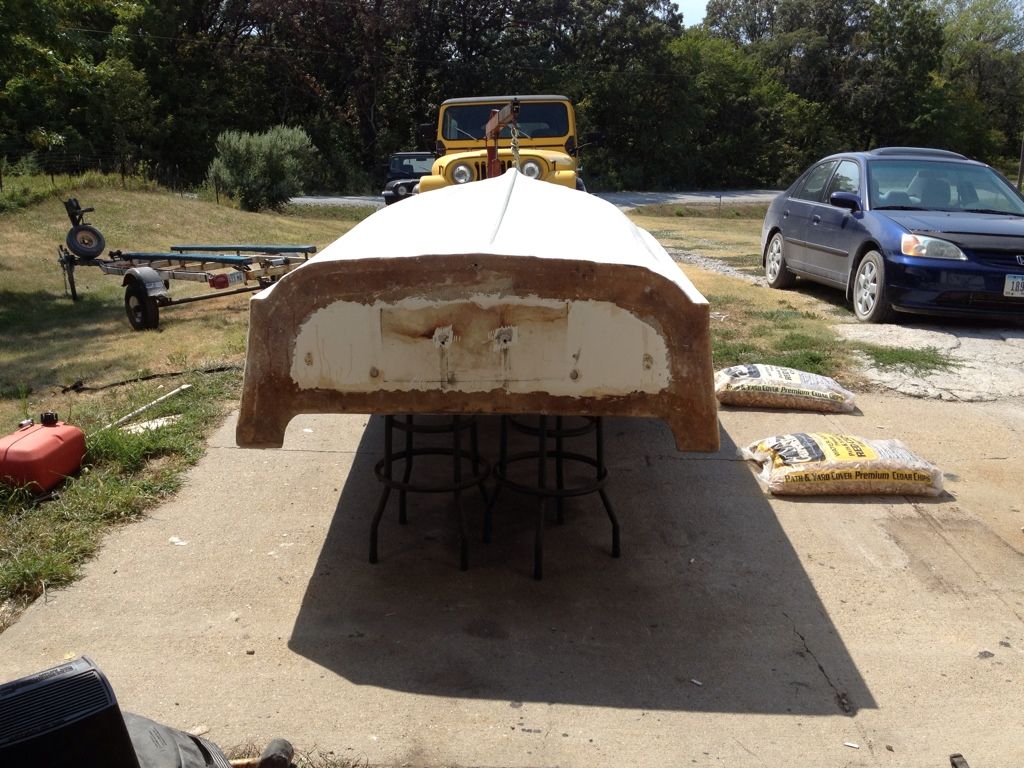

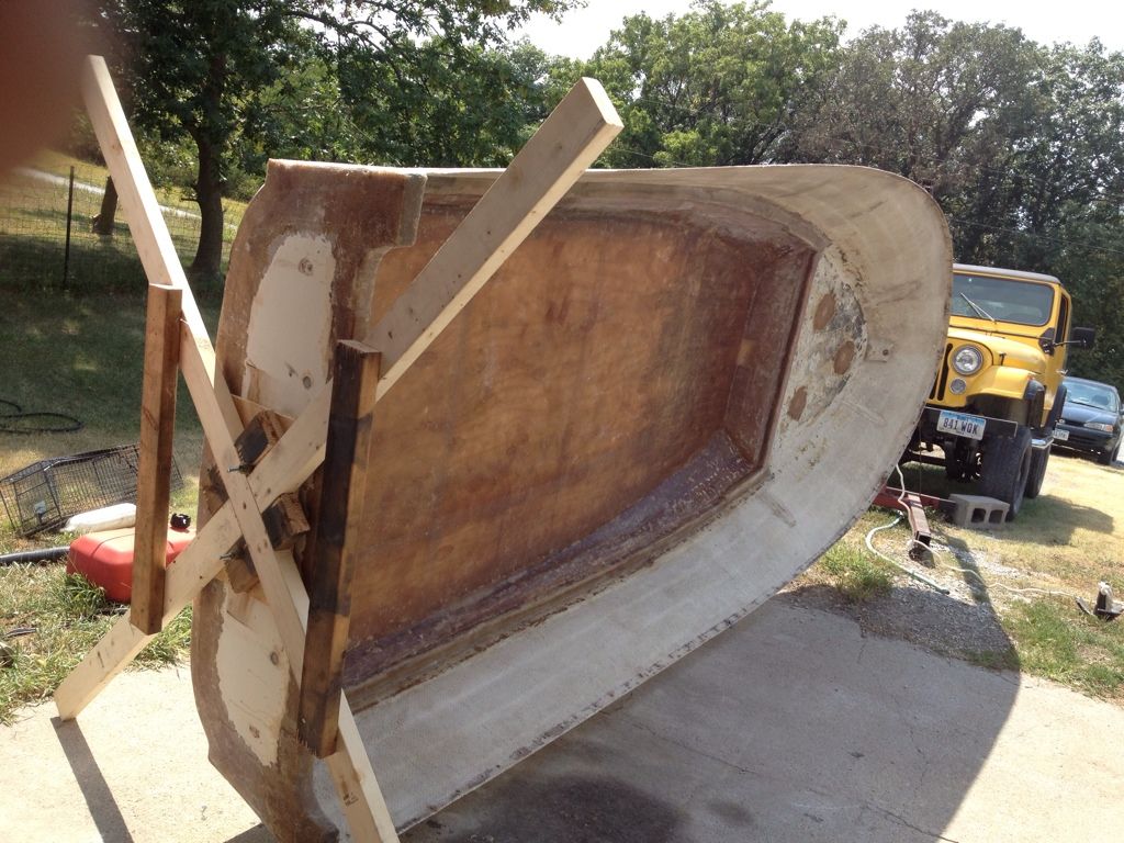

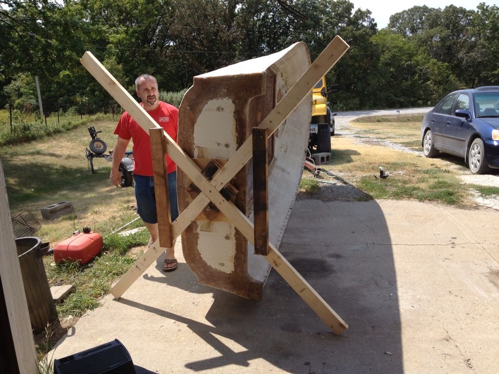

We got the boat flipped today. We did it by making a form we roundtabled earlier in the week. We designed it to be like a wagon wheel without the wheel just the spokes and then bolting it to the transom through the motor mount holes.
Once it was bolted in place we lifted up the bow with a cherry picker and bolted to the transom well he lifted the trailer up with the Jack. Then we started rolling it.
Getting it on its side wasn't too hard but then the unbraced part creaked a bit and scared us. Once we braced the cherry picker against the front of my jeep the movement was eliminated and then we He-Man'd it over on its bottom.
We put a couple of sawhorses in the front of the boat with the 6 x 6 and in the rear the boat I used barstools, a 6 x 6, and a couple other boards to hold it up.
