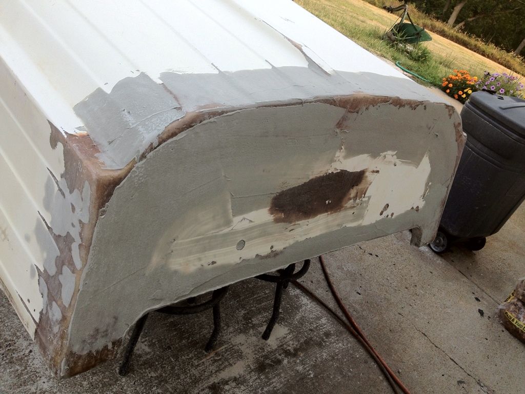

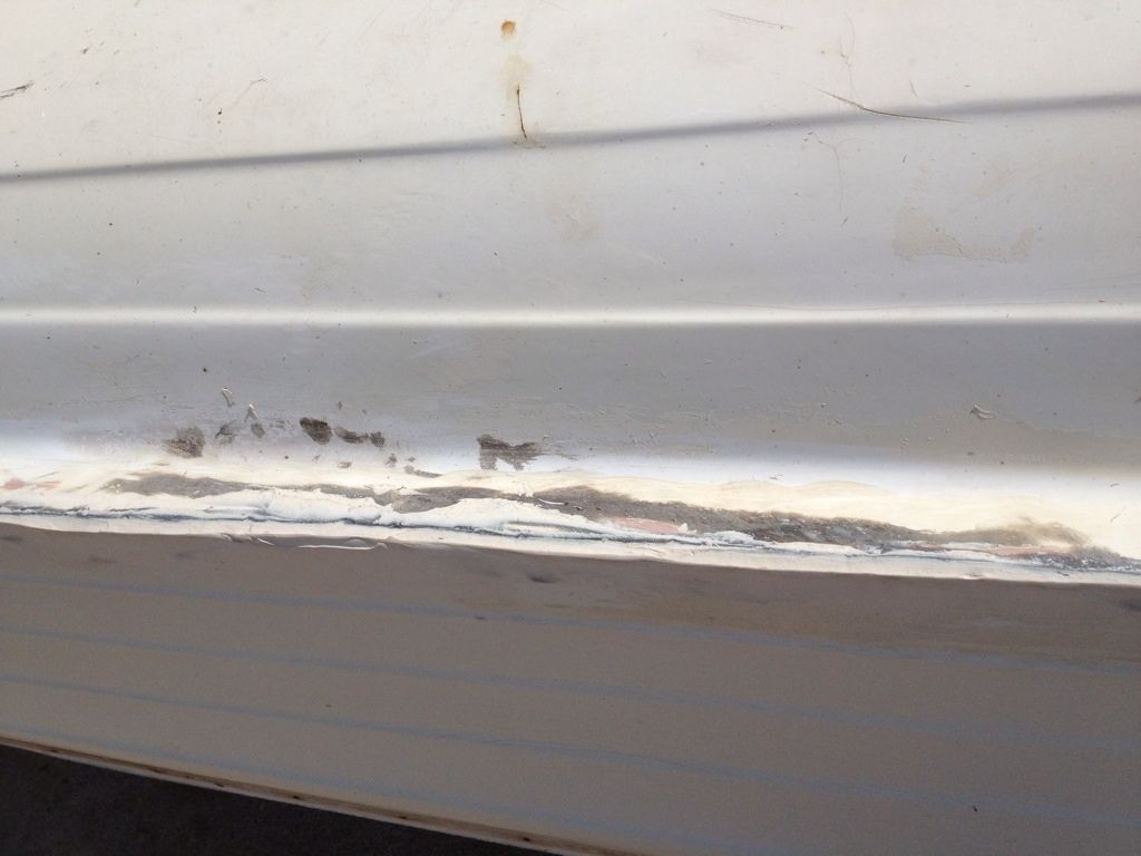

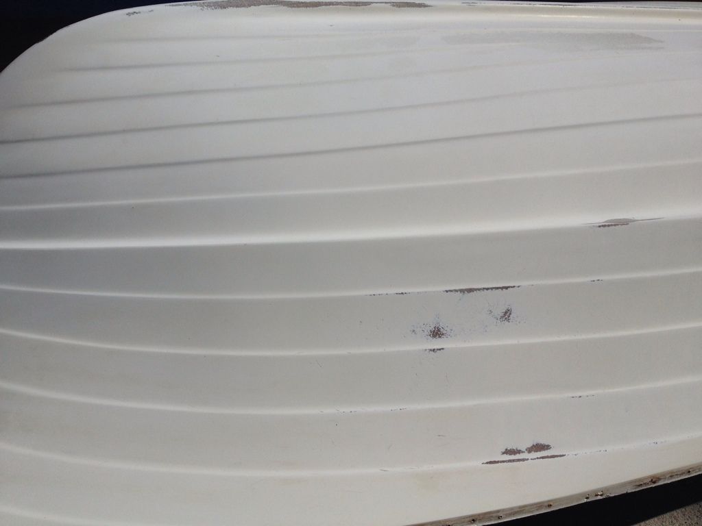

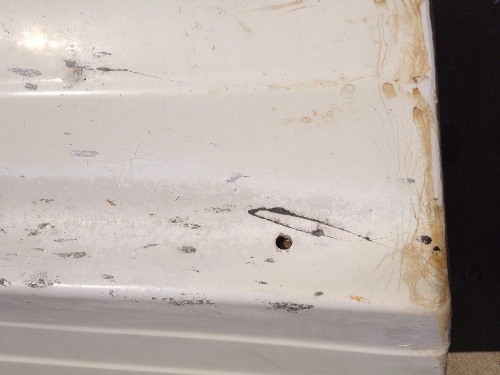

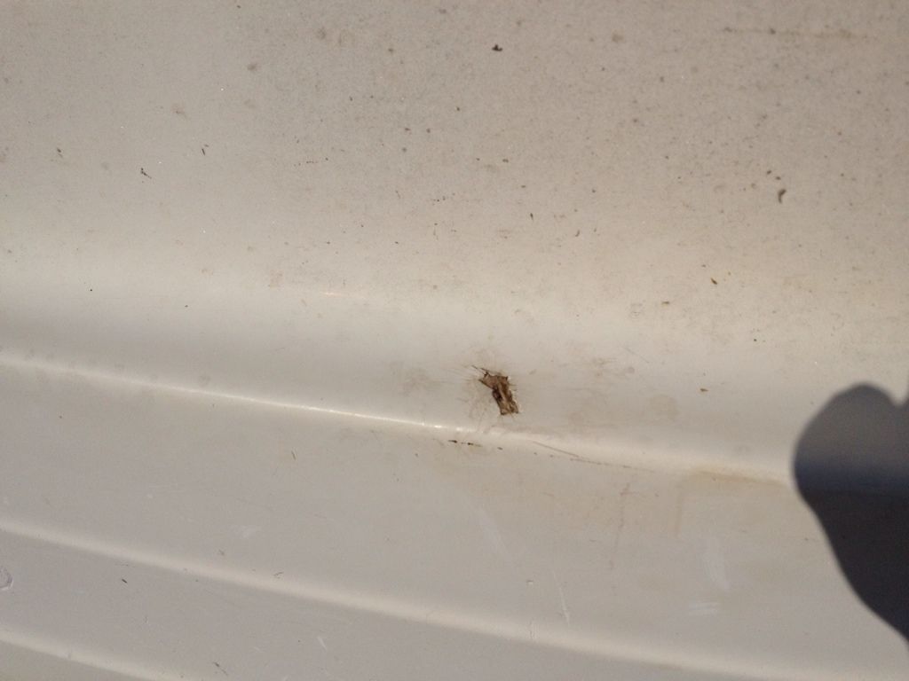

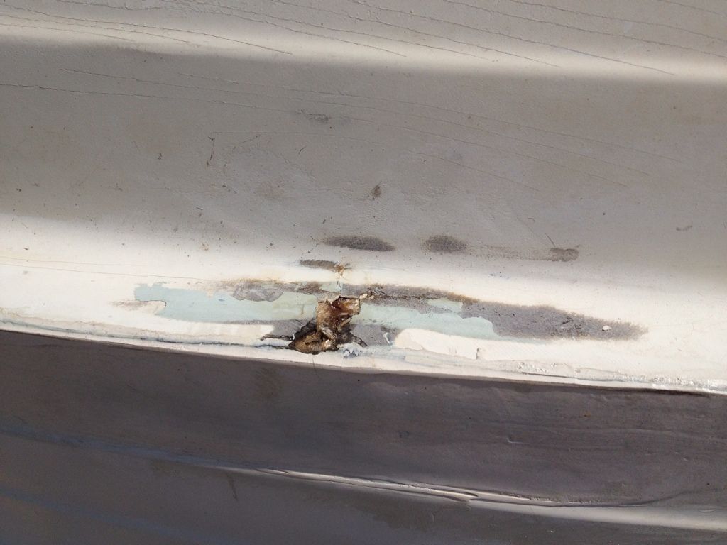

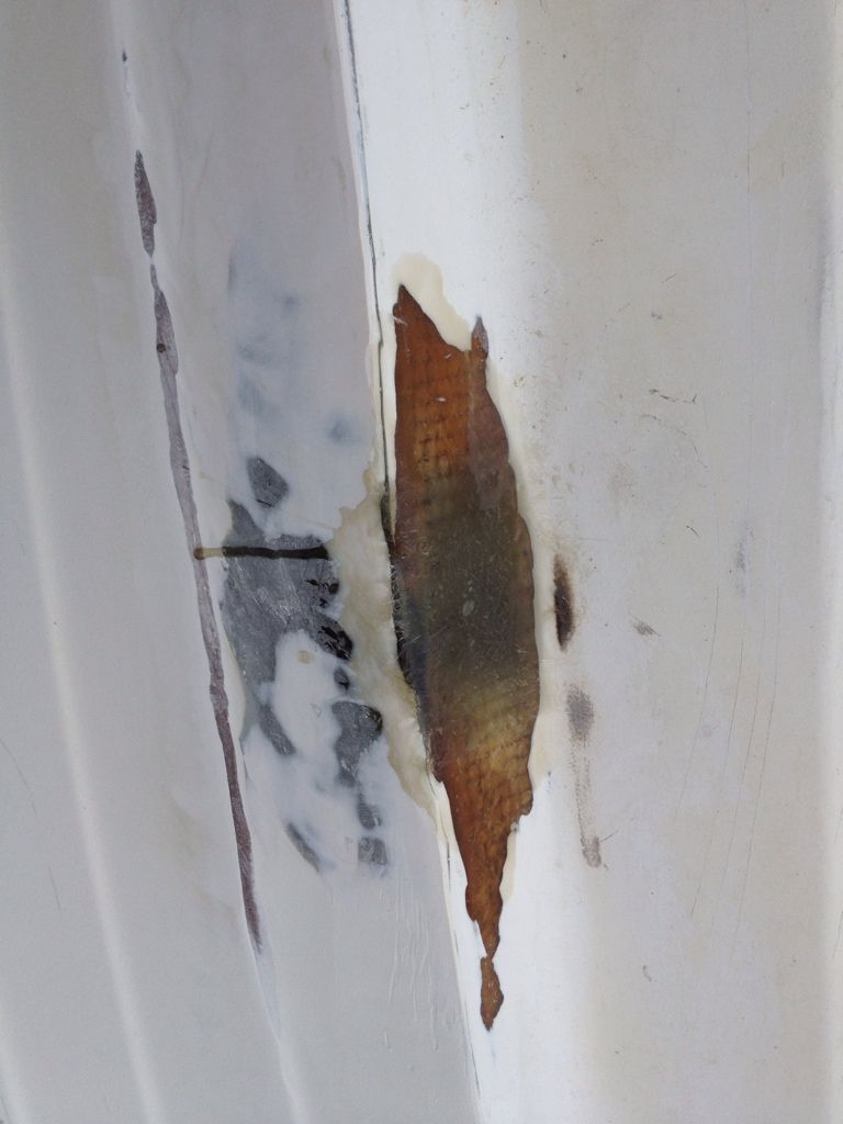

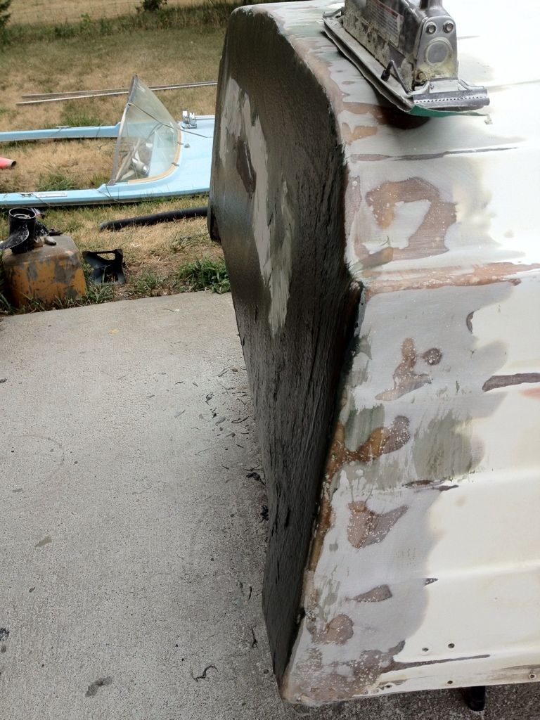

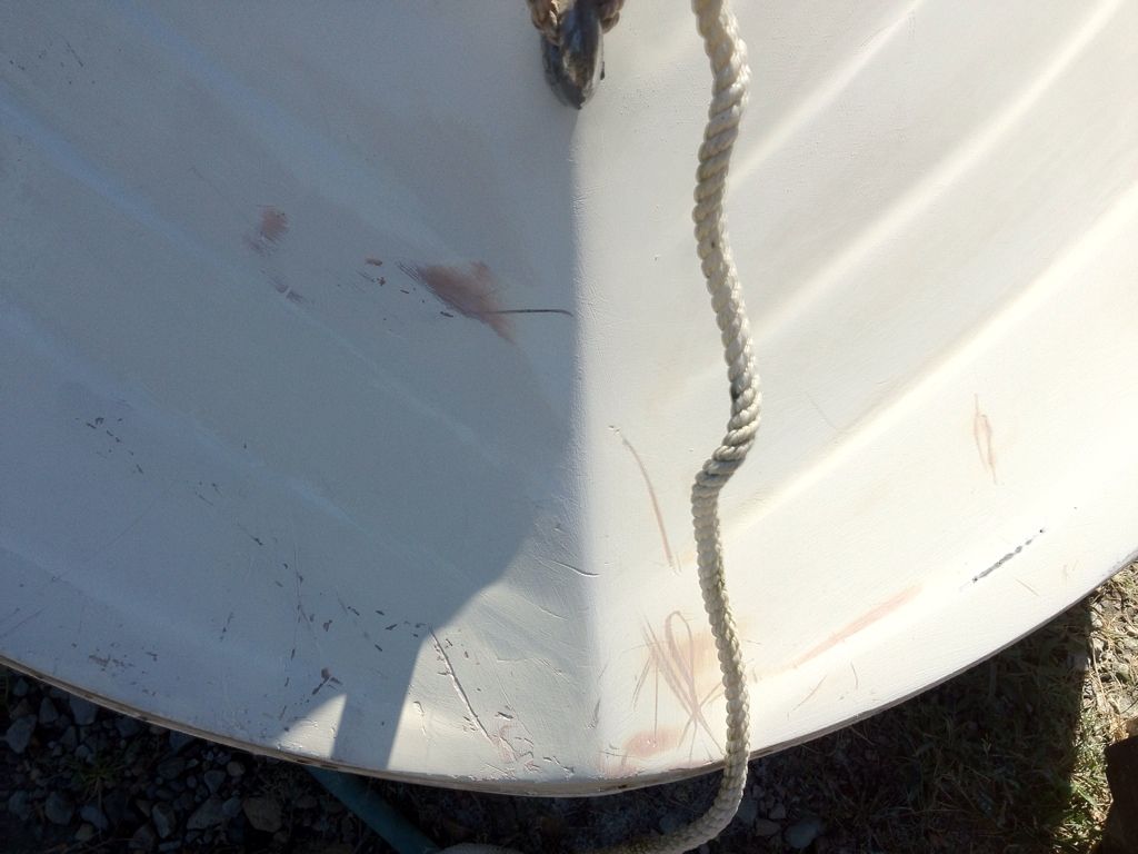

I then inspected the whole and found only three minor parts with damage. Unfortunately these were caused by me. One was a drill a hole up above the waterline where I was trying to weaken some filler material when I was getting it. The other two were from me popping a screwdriver through that same runner trying to get the material out as well. They were all sealed in nida-bond when I poured it but I ground then down to fill with fiberglass matting and resin. Sometimes I'm a little too eager and not that bright. Lol

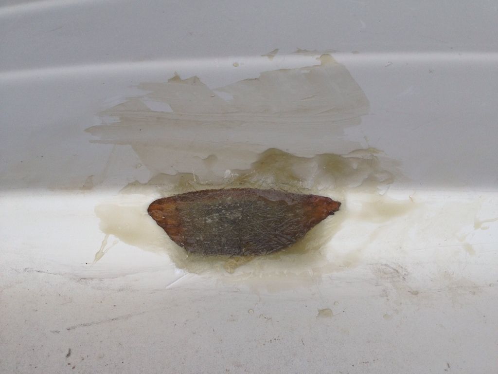

This one was just crappy repair I did years ago from some damage it originally had. It just needs to be sanded down the most part.
