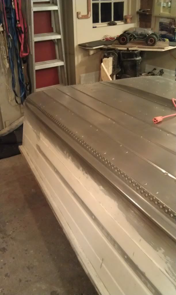

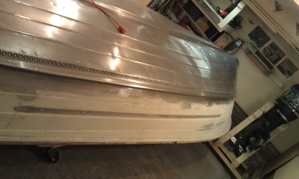

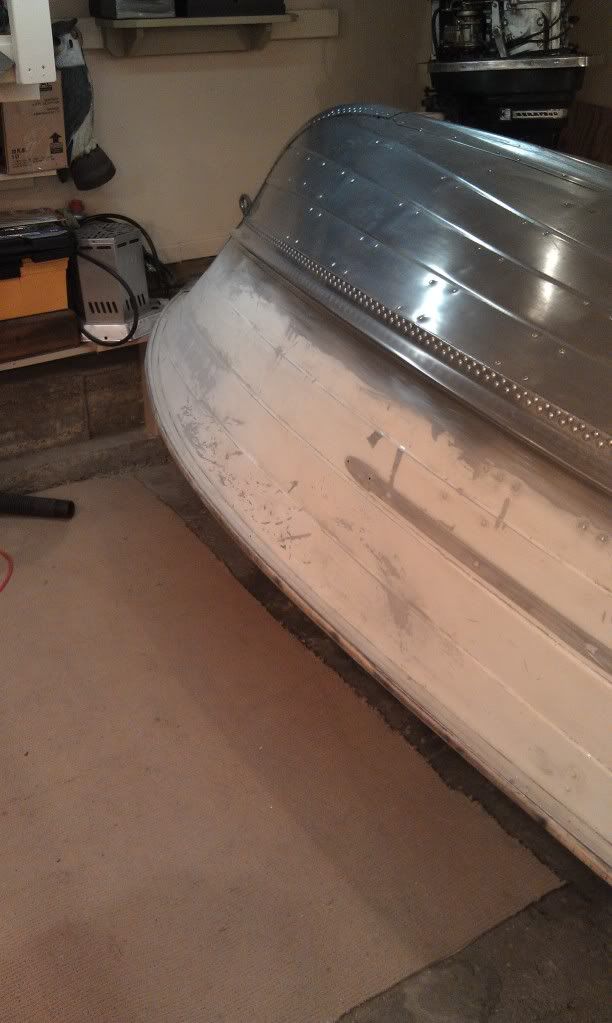

Managed to get out to the boat before 5:00am this morning and got some stuff done. Sanded the sides, transom and dock rash spots in preparation for painting later on (more accurately --- when it's warm!). Here are some shots:

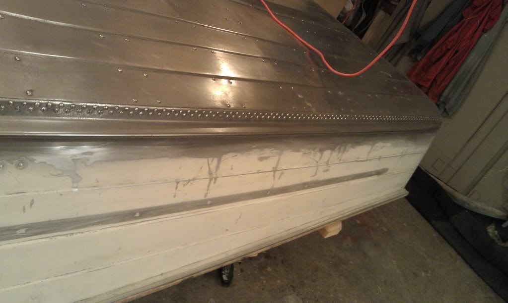

Also got the rub rail pc's removed a while back and the rivet heads ground down smoothish to the side of the boat:

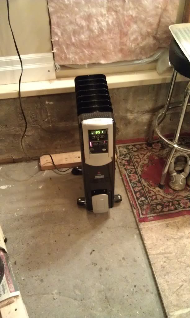

Another note is I really like the following heater...
The temp outside is:
But the temp inside is a nice working temp of:
Not bad... and the nice part is that it costs in and around $45 a month to run. Kerosene would be a lot more and I would be always heating the garage up from a cold temp as well... nice to walk out and it is nice and toasty! Just thought I would share that with you guys!

Morning Jim, sounds like a plan for the corrision pitting. You will just have to make sure to use a mild acid of some kind to make sure you get the Sonus off so the Gluvit will adhere. Glad to see you came up with an economical way to heat the garage, hope it can keep up in the Arctic blast that just went through. Good news is we are on a warming trend here again, so you should see it in week or so. Yesterday morning it was -24c with a windchill of -34
