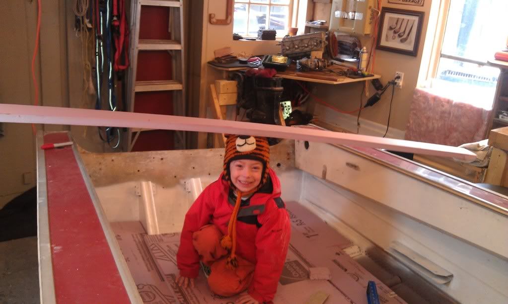

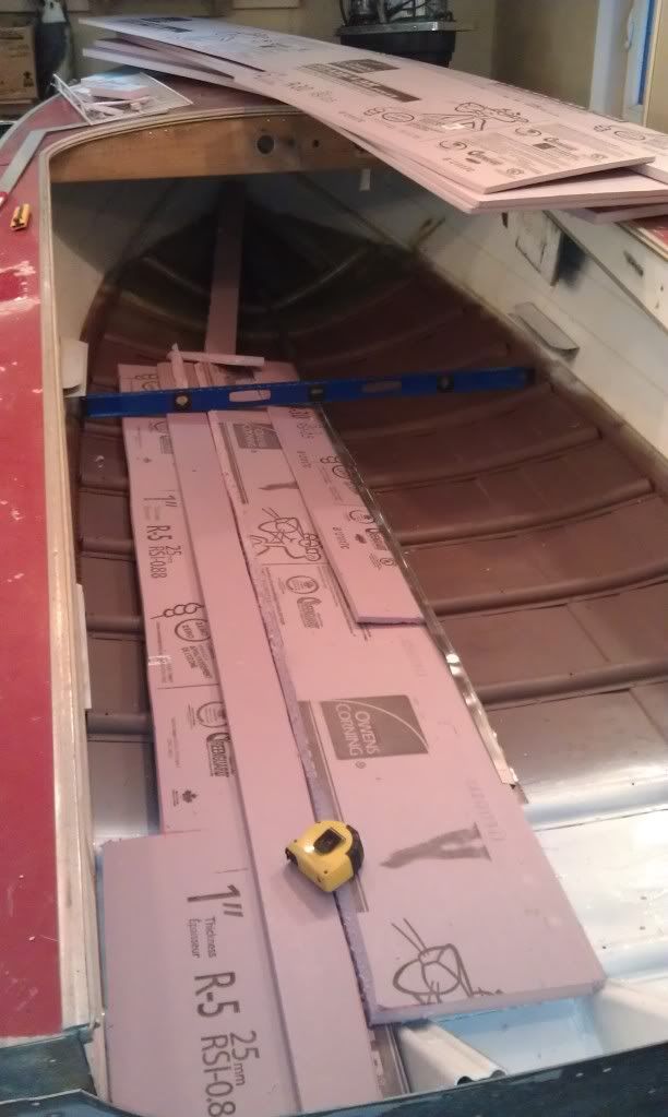

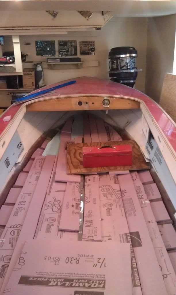

Ok. Just one piece short of finishing the floatation... but first... my little tiger helper was instrumental in ensuring that all piece of floatation were light enough to act as floatation:
One side layered in...
and the other side (under the tiger) also layered in:
Just have one side under the bow to complete. Then it is floor and transom time!
Have a great Sunday fella's!!
J.

Tigers are known for their expertise w/ SC flotation foam? Who'd have thunk it.... Maybe the key is using that pink panther brand :target:
Looking great IM. How many sheets were you able to stuff below decks? 2" thick?
Thanks man! Got 4 full 1" sheets + 1 1/2 half inch sheets + another 3/4's of a 1" sheet to come shortly. Not bad at all. I plan on adding additional foam later under the gunnels and up under the bow.

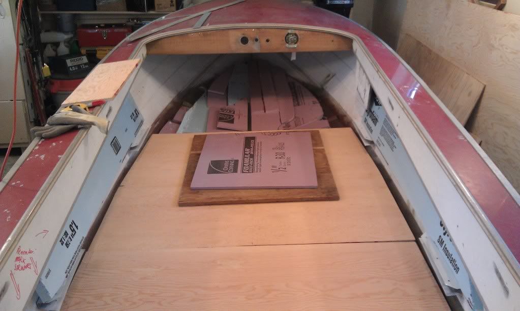

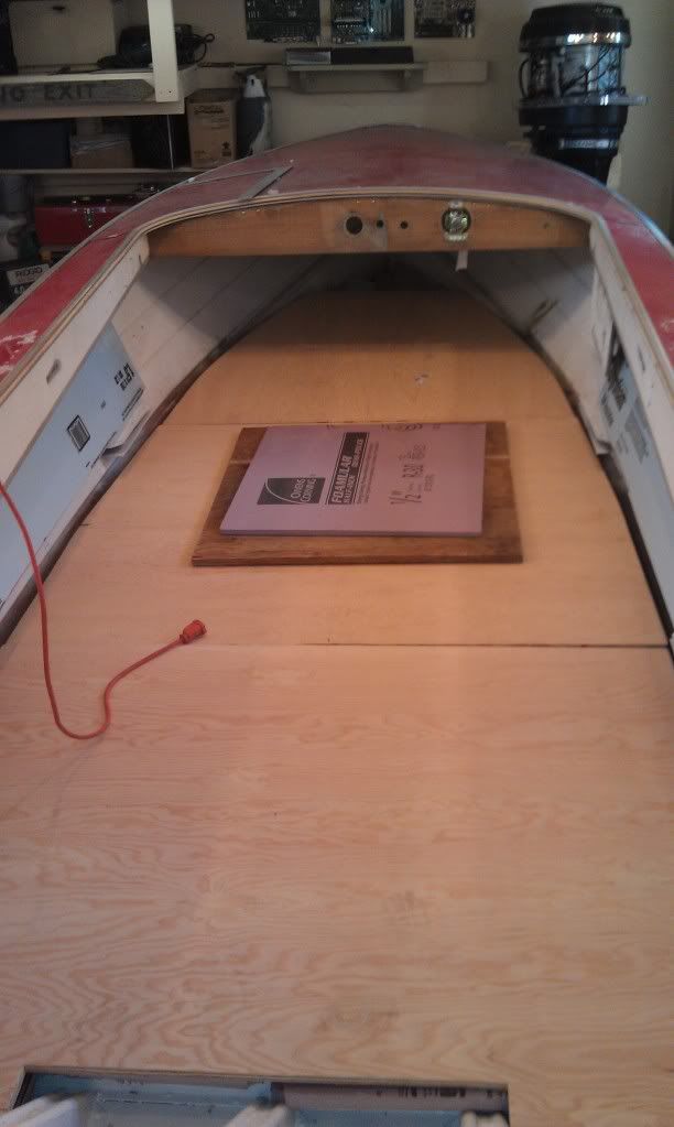

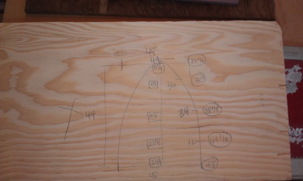

Ok.... Some floor action today.
First got the flotation sorted out and sat and made Vrooom Vroom noises!
Then I got the first and second pieces cut and test fitted:

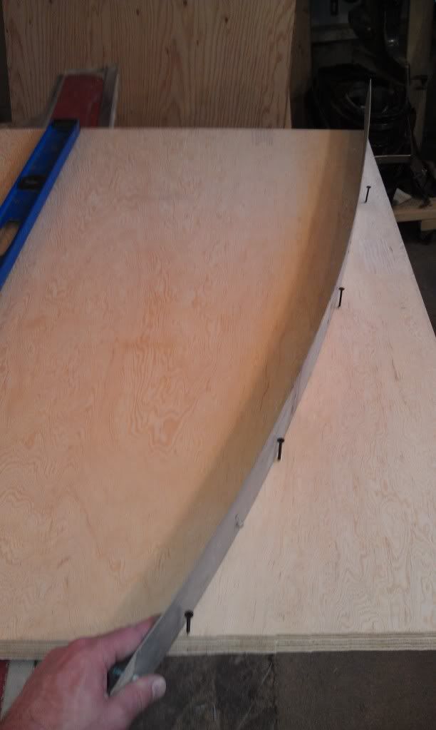

I took some measurements --- using the maximum width (48") I drew a center line and measured under the bow every 12" and then measured across the boat to get the width. The circled numbers are the total widths and the numbers in squares are the total widths / 2. Here is the little template:
I then transposed the measurements to the piece of Douglas Fir ply and using screws and a scrap of aluminum created the proper arc:
Cut and fit in place:
As usual, all cuts (except the ends) are 45 degree cuts.
So there you have it... floor is for the most part done. I have a little piece at the bow and the doublers to cut and fit tomorrow. Also, I should be able to get the transom cut as well so that I can kick off spar varnishing on Sunday!

Neat idea for getting the curve.

Great work IM, looks like a real great fit.
Thanks Ez --- but credit where credit is due Glen showed me the idea --- I just used screws instead of nails and I used the old aluminum doublers... can't remember what Glen used.

Floor looks real good Jim, nice fit. Have fun on the hike.
