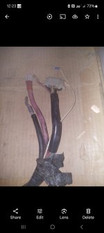

Hey i also have a 1966 evinrude Lark 8 40hp electric start i payed $25 for it it has no controls i was wondering if i need to find a junction box and controls to run this ir can i use a manual.shifter cable and.not.hook up the elecric.shift
39,467
You can not hook up any kind of manual cable to shift this motor.----Needs 12 volts to green for forward.----And 12 volts to blue for reverse.-----Needs a working belt driven generator as well.----Your location ?------Best to do a complete evaluation before spending any beer tokens on it.----Post compression numbers.---Test shift coils.----Pull flywheel and inspect ignition coils.----Install a new water pump impeller before launching the boat with this motor.

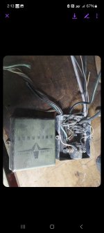

Ok is it safe to atleast hook up positive,ground, and white is ignition for electric start right? Just to test before i dump money in it ? And if all runs can you send me a picture of whate control box and controls look like so i can search what i need ive looked online cant find
39,467
I know those motors inside and out.----I know where to find parts.----Do not know how to post pictures.----Your location ?
39,467
The junction box also needs the voltage regulator.----Post some pictures of the powerhead.----I am too far away to provide any more help.

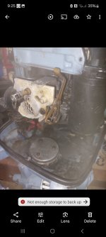

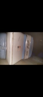

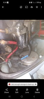

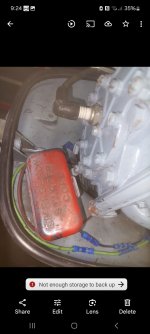

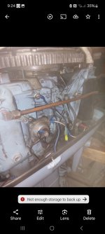

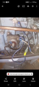

Sep 28, 2018
20

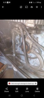

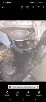

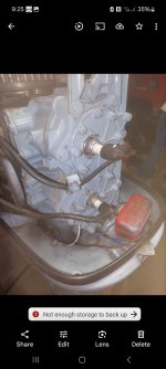

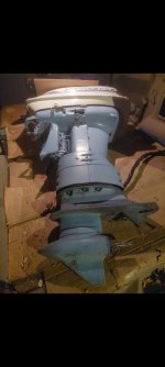

39,467
Sorry-----I do not consider that to be a " clean " motor.-----Good luck with it.----Model # is ?----Serial numbers the same on swivel bracket and powerhead?
Sep 28, 2018
20
Yes the model.number is the same.on the swivel.bracket how do i test the shift coils and location.of.them?
