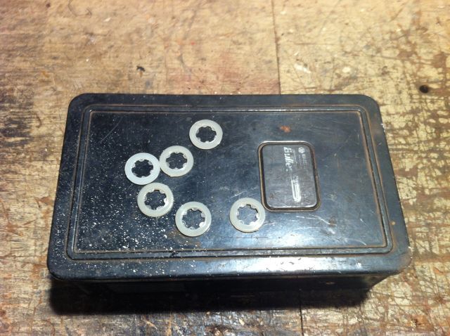

Picked up a pump today at Princess Auto,plastic washers and a bottle of marine outboard gear oil.
I did take the level plug out tonight and the washers I bought are all wrong, too big and much thicker than the original one. Good thing it was only $3 for 6 of them.

The washers you need are part #0311598. If the pump isn't screwing in far enough, check to make sure there's not an old crush washer still in there. That oil is fine.
