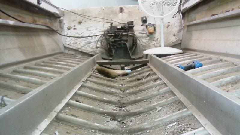

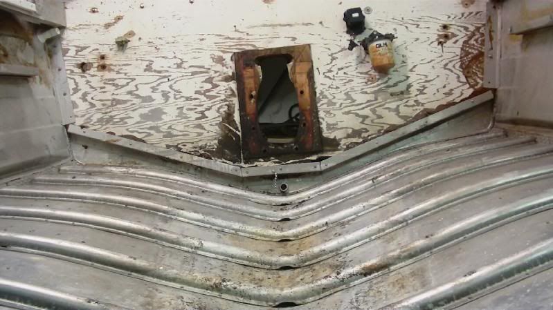

I didn't get to gluv this weekend, didn't do much for that matter. So today i took the rest of the out drive housing out. Got to see how rotted the transom is, but will be attacked later on. OK, i wanted to make sure that all water drains leading to the bilge pump work. I noticed when washing the boat that water would take loooong to travel to the bilge.
Soooo, I used a thin screw driver to poke through the drain passages and u guessed it mud and wood debris stuck inside the hull supports. After washing the debris i noticed that water drained a little faster. I decided to open the drain by prying them open more, not hard to do just worried that it might damage the hull, but no problem there.
On the pic u can see the results. Now it drains fast or a whole lot better than it was.

Looks good. That transom should be a snap to replace. That hull has a decent V to it so it should ride pretty well in the chop.

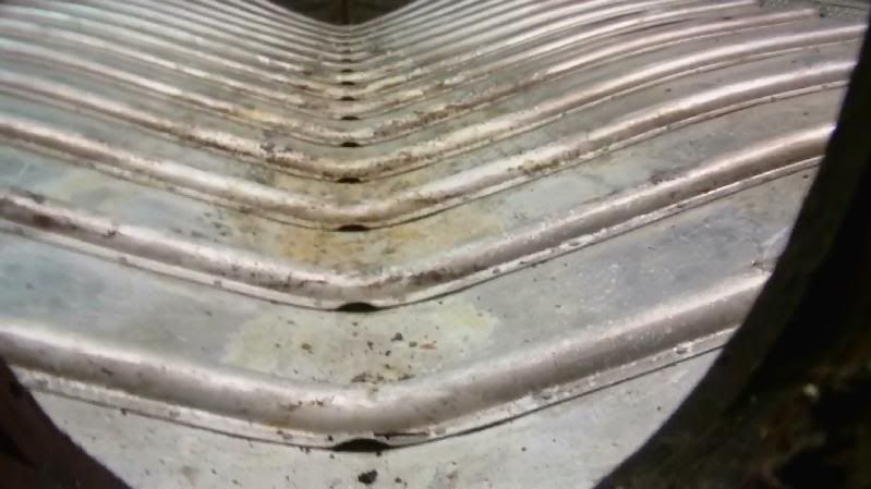

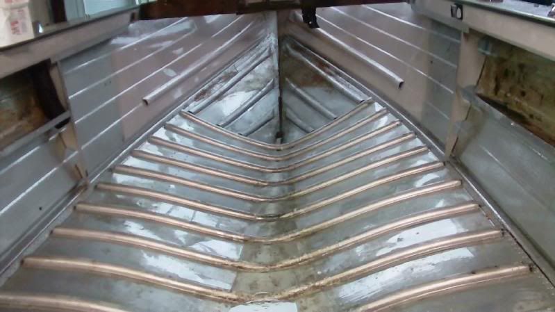

Finally the gluving. It took me an hour to gluv my tin can. Though I used up the whole quart, im thinking about ordering another quart & giving it a second coating. Pretty easy stuff to apply and no toxic odor that i noticed. I wish they had a spray form, now that would make things easier.

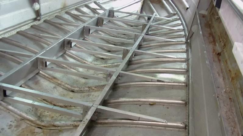

Riveted the stringers! I dont know if you guys did what I did but I got little bigger rivets. Im guessing this starcraft had 1/8 rivets, well i went ahead and got 3/16 rivets. One size larger. I did have to drill but that was a cinch. If I ever do this again I would use 3/16 rivets with a 1/2 grip. This way it wont rivet above the frame. Had it happen to me and had to re drill them out & push down on the stringer to make sure it riveted flat on the rib. Any suggestions or opinions.?

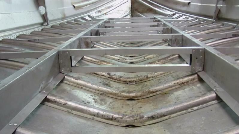

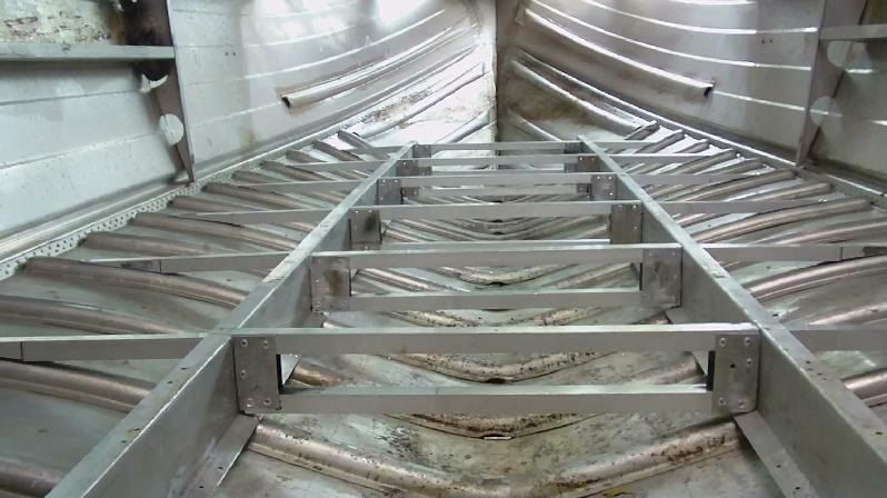

Sorry guys that i haven't posted in my project but have been researching and been planning how to reinforce my hull and some other topics. After some thought and budget planning i realized I can reinforce the hull with rectangular braces. I started this Sunday morning. Tried different ways to make these rectangular braces with out having to weld, Will plan on a welder later. I tried the alumaweld brazing rods, they sucked or maybe i wasn't doing it correctly after a day of experimenting i just gave up and decided to go back to my original plan of just riveting the braces and then rivet them to the stringers. I was also thinking about JB weld but I think it will cost more that whats its worth.

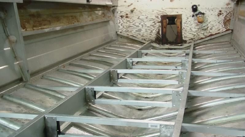

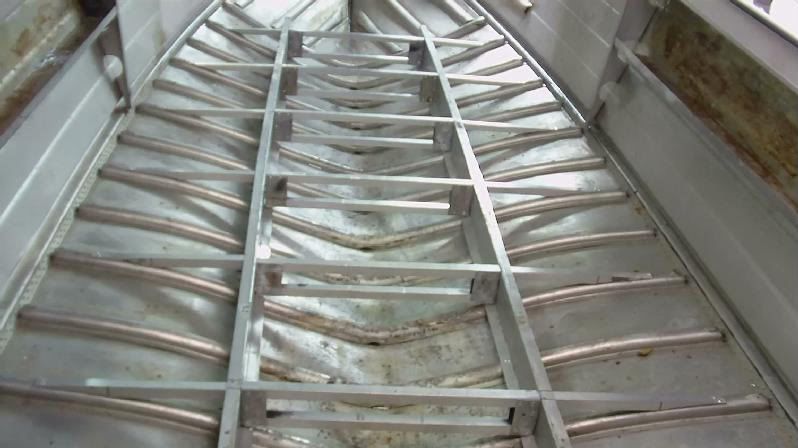

It has been a while, but have had some priorities needed to be filled. But finally had time to progress. I FINNALLY finished my reinforcement of my lower part of the hull. All thats needed now is the wood deck. I will be adding rivet nuts to aluminum hull so I can bolt my floor. I want to be able to remove my floor every once in a while. I will be adding foam later, but will cut the foam so it will be about a 1/4" above the stringers and braces. Reason,,, when i bolt the floor it will create pressure therefore a more sloid structure,,or so my reasoning. Opininions welcomed.

Meticules work there bud..I like the alum supports between the stringers..
I did the same thing..But cut 2x4's and waterproofed them..then drilled them in from the sides of the stringers..

Whats up CheapboatKev. Did u feel a difference on water after u installed the supports? Im wondering what kind of ride this will produce. Im also gonna reinforce the walls. I hate the twisting it does!

I really like the supports you put in. I used 2x4 like CheapBoatKev. I really didn't feel any difference in the ride. It mainly helped with securing and supporting the deck.
