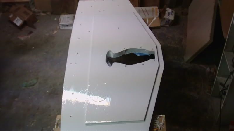

Birch ply is usually used for cabinets & furniture were looks is a must. I just used it cause it was already cut & the price. But from what I understand birch is prone to rot, so encapsulation is critical. My transom is gonna be all white. Sorry but thats all iknow v8mgbal.

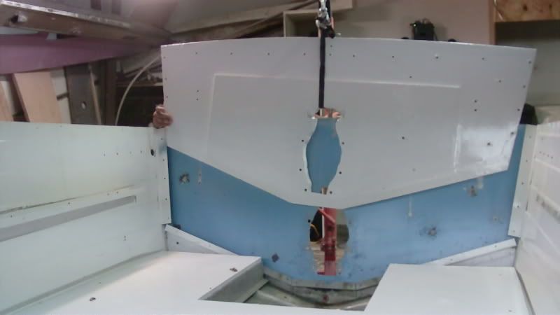

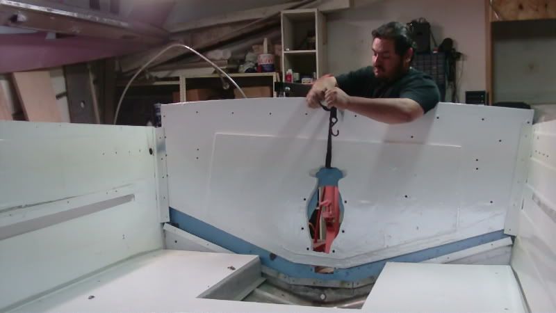

Finally the transom is done. Little by little. Now for the bellows & shift cable

Nice work. That transom will be around for some time to come considering the extra thought put into it like epoxy brushing the bolt holes.
I cut my 1/2 inch backing plate larger as well. I did it in three pieces to be used for backing for a possible ladder, etc. Had I thought about it more I would have went to a larger piece as well for the extra rigidity.

Looks good, nice work on the transom. Looks ready to bolt on, and should be in service for a long, long time.:)

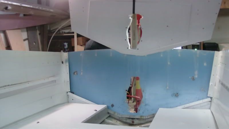

Well,, with all the epoxy it made things difficult.
Tansom was harder to slide in because it was thicker.
SO had use hammer. Right the hammer. Finally it slid in.
Now installing bolts was another thing. Now i had to move the transom by milimeters in order to get the bolts to slide in. Finally nice and tight fit. Gonna do some touch up painting and then moving on to the transom housing.

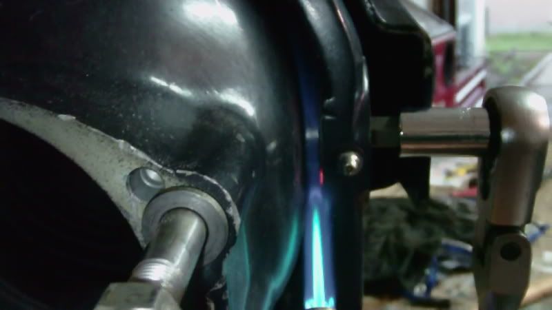

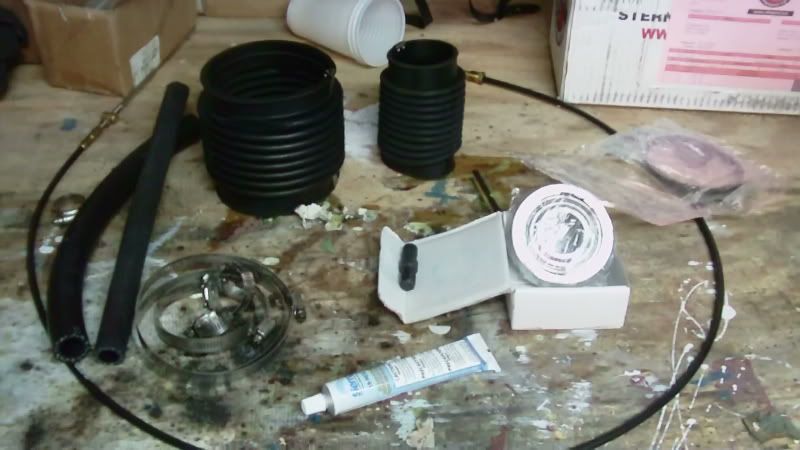

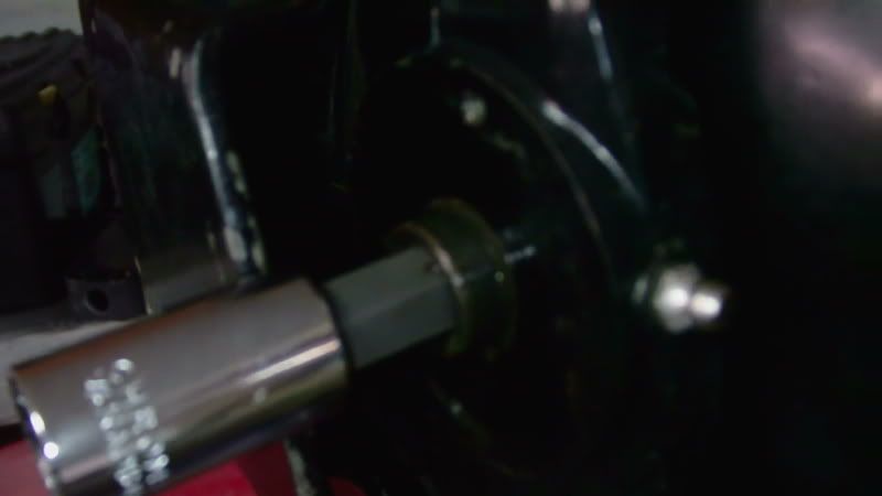

Like I said before ,moving on to the bellows. Ordered the reseal kit.

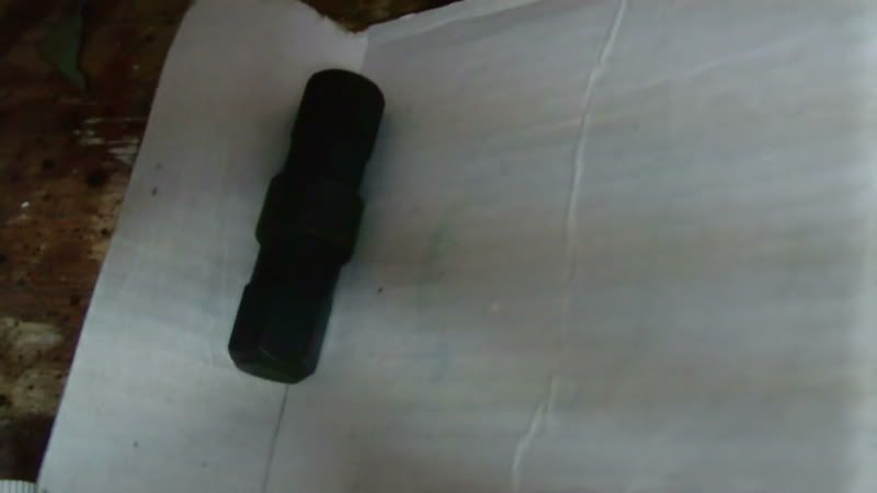

ANd the hinge tool.

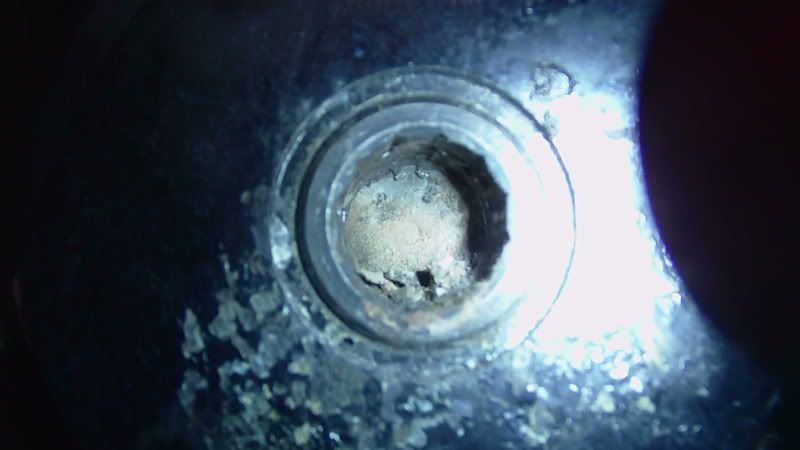

I was one happy camper till I got to removing the hinge bolts. The bolts striped!!
Both sides. Crap man, murphy just likes me. So now what do I do... hit the research button. Will be back with more news or pics.
North Beach
Sep 29, 2008
2,022
Re: 1968 Holiday Restoration w/pics
Azlo, Stick a bolt in it that is close to the same size and tack weld it and screw it out!
Azlo
Jun 21, 2009
706

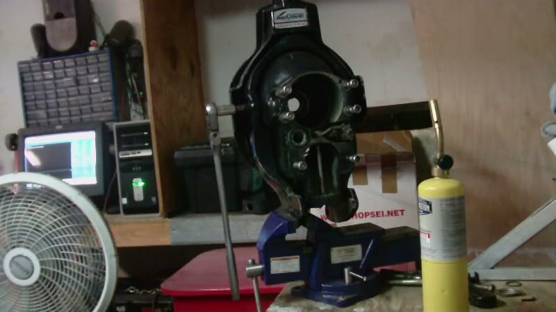

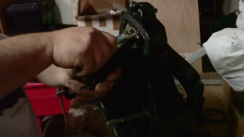

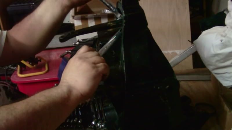

AFter some research found ot that this bolts strip all the time. And u have to use heat!! So i got my propane out & hheat away. Let take a moment to vent.. this hinge pin tool, from my experience isnt worth the box it was shipped in. The half inch allen socket was what worked for me. The diffrence i noticed was the hinge tool fit loosely while the allan socket was tighter. Now it might be because the bolts are stripped but the allen socket beat the crap out of murphy today.
Used a brekaer bar and.....
used also my maps gas.

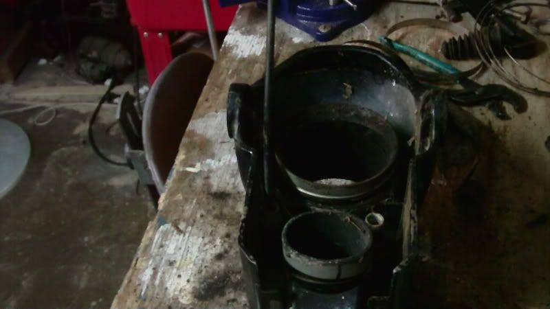

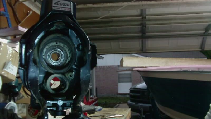

vooalah!! Bolt came out,no striping, little stress. This was a KO in the second round. So now that I wasfeeling good again. I went ahead & removed the bellows.

On a side note I noticed that my fork was loose and you could move it back & forth in the housing. So I loosened the steering shaft & then retighned.
Worked out great! No slack good nice movement.
