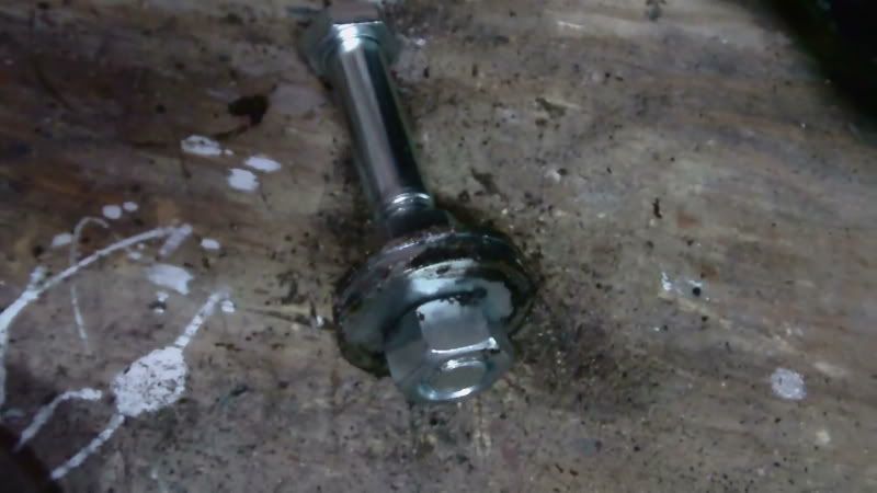

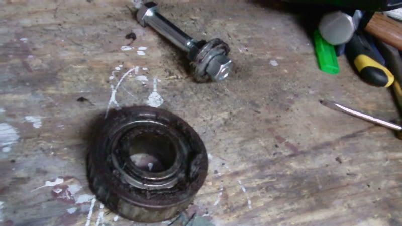

Yes sa, im on the roll. I was gonna buy an 80$ slide hammer to take the gimbal bearing out, but I gambled on an idea. When to the hardware & got 2" washers & bolts to go with it.
Believe it or not I drove the old bearing out with 3 hits with my mallot!!! What?!?!
It worked!!
I dont understand that it was this simple. Surely theres something im missing. I know I will have to replace this seal.
But other than that,whats up?

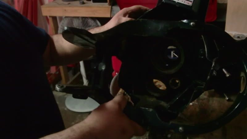

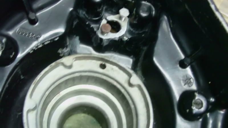

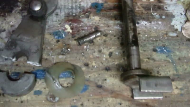

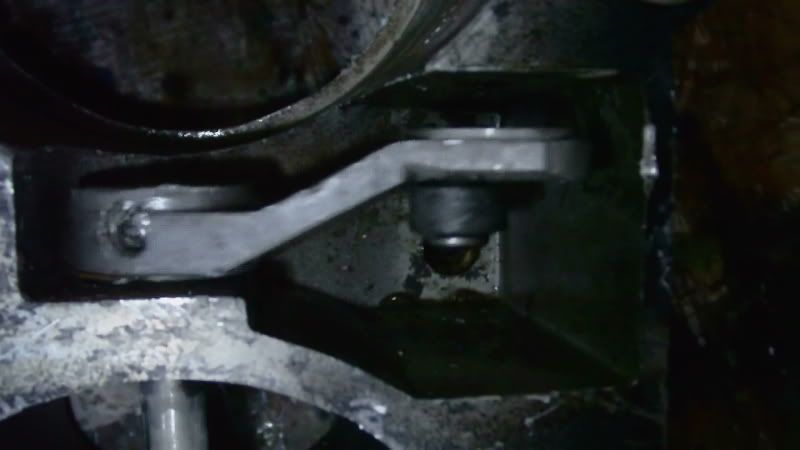

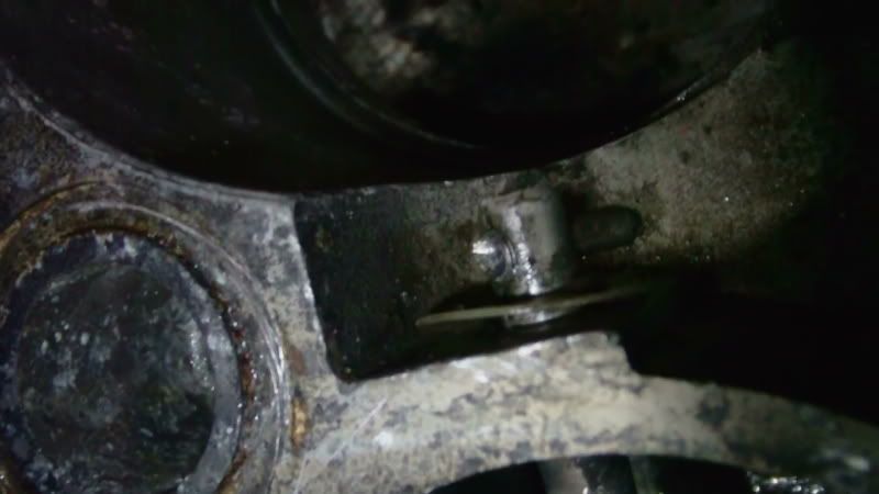

I decided to go ahead & inspect closely the housing & components. Im glad I did. I dont know why I didnt catch this but the shift cable had a broken bolt in it.
I had to brake the lever , so now on my list to get, i have included shift cable lever & bushings.

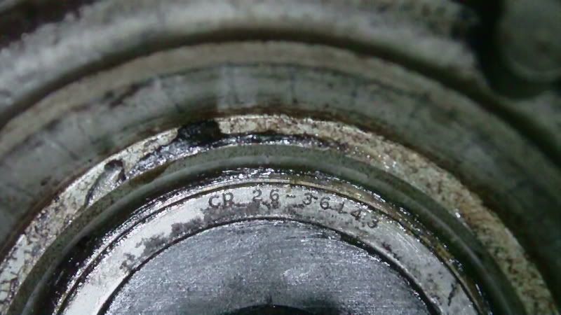

Evrything else in the bell housing looks good. Moved on the housing unit. Removed the gimbal bearing seal and decided that I should inspect the fork bearings. So I removed the fork even after I had adjusted it.
IM gonna put all of these in the parts washer & let them soak & do some further inspection.

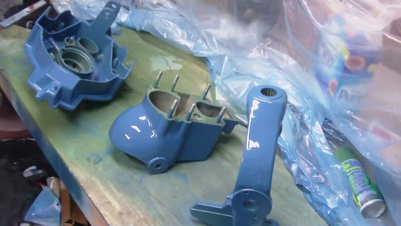

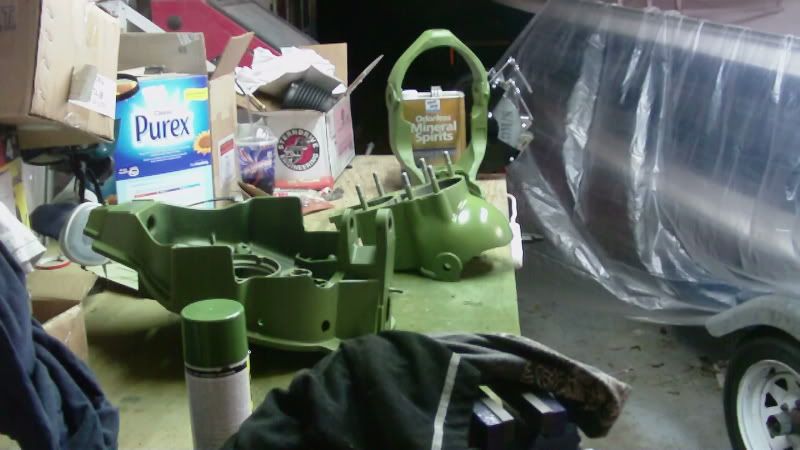

After the last pic I noticed I need more lighting. Went to home depot & Got me some t8s to light. During the week i had left my bell housing in the parts washer. I got tired of experimeting with degreasers that I just gave up & used straight laundry soap!!!:redface: SO today when i removed my parts, not only were they degreased but they were smelling good!.
I was surprised at how clean my parts. Nice. So with that done I sanded my parts a little & Zinc chromated them.
Then Painted them with rustoleum blue. They turned out great.
Looks like painting skills are improving.:) Once assembled I will recoat again. I hope you are all having a good weekend as I am.

The blue end result it fantastic. I think you can safely go much lighter on the ZC primer though.
