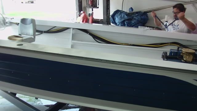

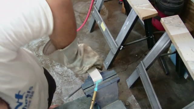

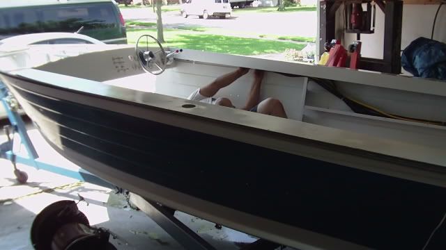

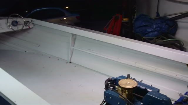

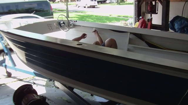

SO I finished riveting my gunnels so i can make brackets to support the wiring and steering cable.
The brackets were made out of aluminum crown and shaped them into an L and that was it.
After installing them they were pretty set. The weight of the wiring and cables made them solid. Will see they how they last.
I wish they were more jobs like this, working lying down.

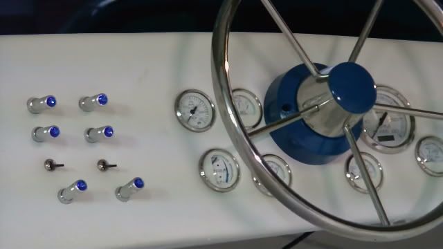

Also installed my last gauge, a water psi gauge. Heard good things of having one of these so went ahead installed. All I need to get is the water tube and thats it.
Also notice I need two more switch extensions to install.

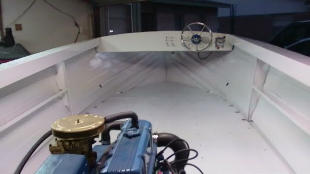

After all that I wnet ahead and cleaned out all my leaves and gave a wash. With the wires hidden in place ist starting to look good!! Getting close. U know I like how it looks with out seats. hmmm.

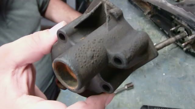

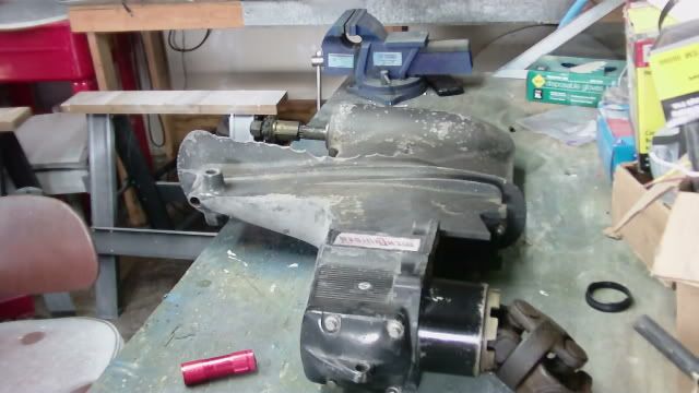

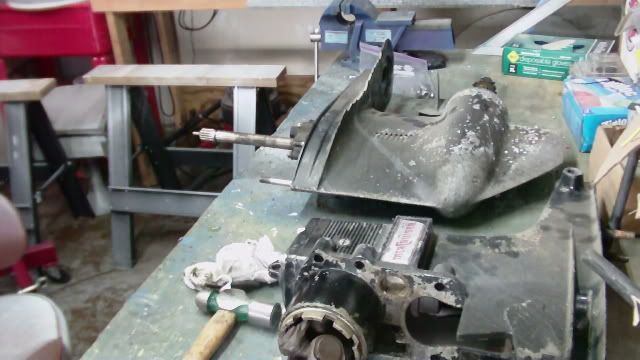

Well, it is now time for the out drive. The last important piece of this big puzzle. I was debating wether to get a new one for a wopping $1300 but funds are not all that available. So I decided to do with what I have right now. If u guys remember the original drive. It looks like it was at Lake Placid at some time of its life.

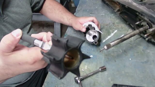

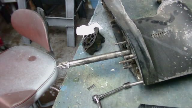

Yeah it looks pretty beat up but im sure we can pretty up a little bit. Im gonna start with the water pump impeller. SO I seperated the two halves, very simple.
Took the bolts off to the impeller housing.
Man this impeller took a beating.
And look the housing, it got so hot it bubbled. I hope this didnt mess anything else up.
