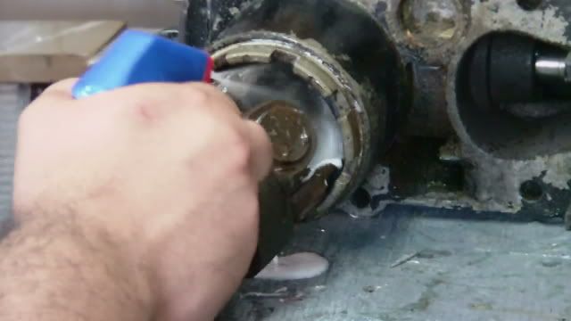

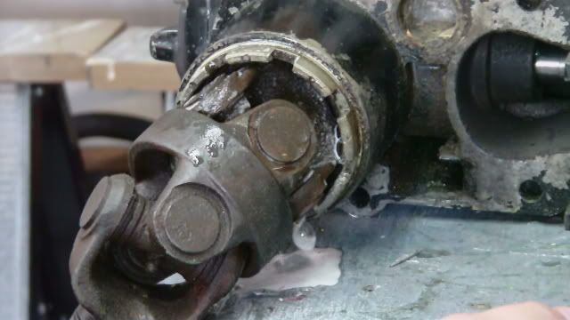

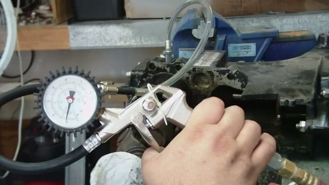

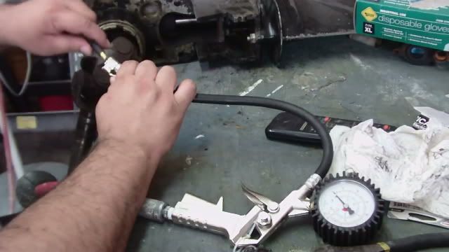

SO now that im ready to install my drive, I decided to pressure ttest it. Went to HF to get a vacuum pump, Autozone to get a tire valve, and west marine to get gear lube pump.
Hooked the vacuum pummp to the gear lube tool and you guessed it. No vacumm at all. It was loosing vacuum big time. SO I went ahead and got the tire valve & hooked it to the gear lube tool and hooked my tire inflator to it.
Slowly filled it to 20psi. But nothing, would not hold pressure. Except this time i could at least hear where it was escaping.
I grabbed some soap & sprayed.
Can u see the leak? The yoke shaft seal is leaking!

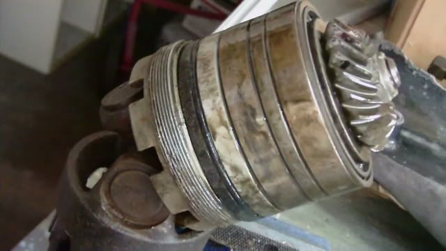

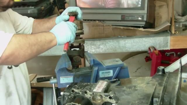

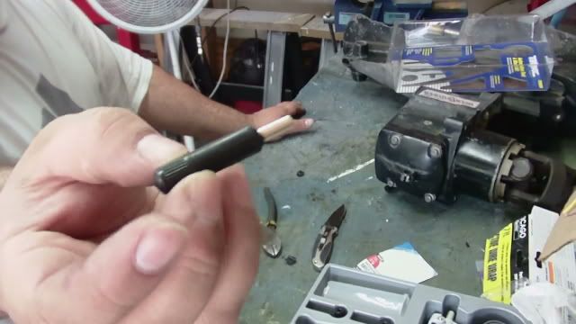

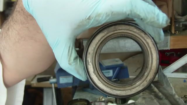

After reading the manual it wasnt so bad taking it out. Actually it was easy. I was carefull not loose any shims and Im glad I recorded it in case I forget how it goes back. This is the unit on the vise.
supposely this gear is suppost to be pressed in but it came out by hand. I think I need to do some more reading.
Here it is folks, the culprit. I could actually feel the wearness of the seal when I turn it on the yoke.
I think im gonna get the upper seals & seal it & see if anything else goes wrong.

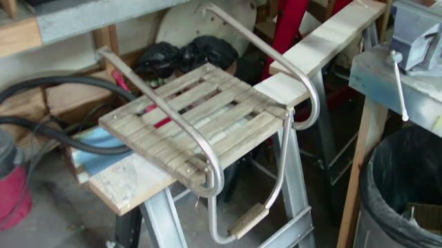

Well friends im doing with what I have right now, since im saving for my drive, but things keep popping up. So with that said i had some white paint left and decided to start on my mini swim deck. The teak it had is still strong but I didnt want to keep maintaining it with oils and so.
SO I decided to paint it white. I didnt know that teak was so absorbent, it took 4 layers of paint! But it looks good.
I know I know, people are gonna say why I painted teak. Well simply im broke & thats all I have to say about that right now.
