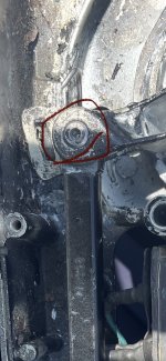

So my lower unit is good. neutral in water barely spins..although i need a new throttle cable or the person who had this control box tried to rig something up not sure but the wire inside the throttle cable when moving the throttle lever just feeds in and doesnt pull anything. Im trying to figure out where to buy a cable in canada
And how this pin comes off i seen a couple of videos of it being a regular pop off pin but on mine its different.
