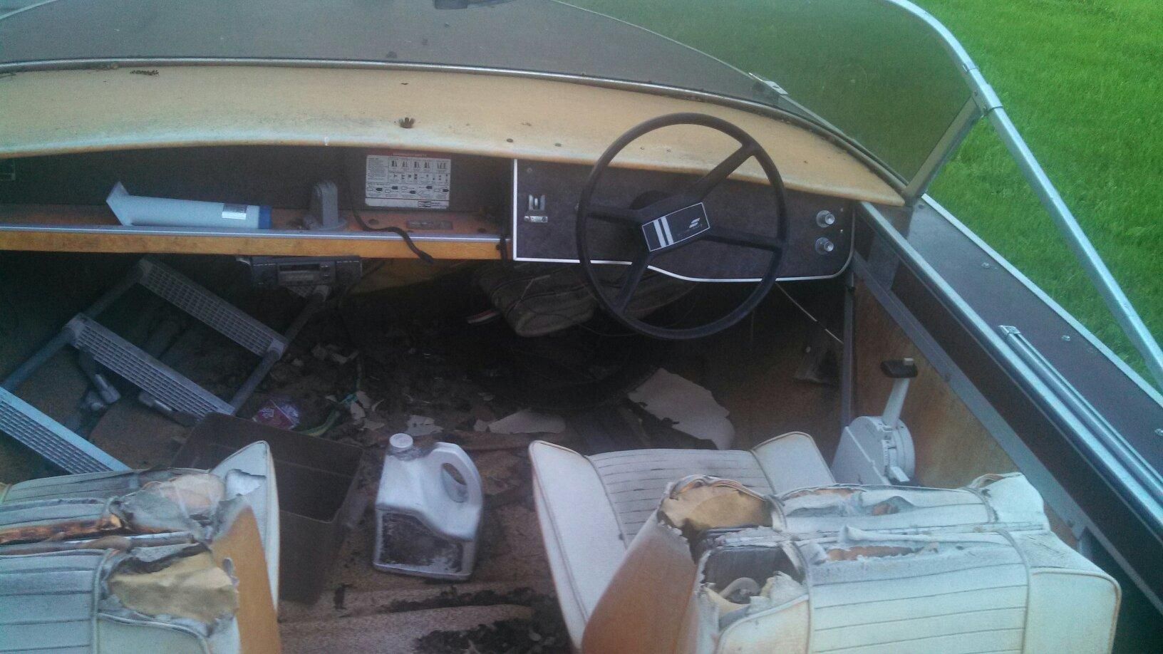

JBCurt, Thanks for help with pics! Yea interior ended as dump but everything else looks solid including transom. All the seats are in the dumpster. Removed old soft deck boards and white bead board insulation except the last 4' stern piece which is fine. Shop vac took about 30 gal of water out. Does it matter what density pink/blue board use as replacement? What is everyone's opinion on 1/2" ACX with 4-6 coats of Varathane Spar Urethane? Planning on marine vinyl for the top. I think did pretty good for $900 w 2 motors.

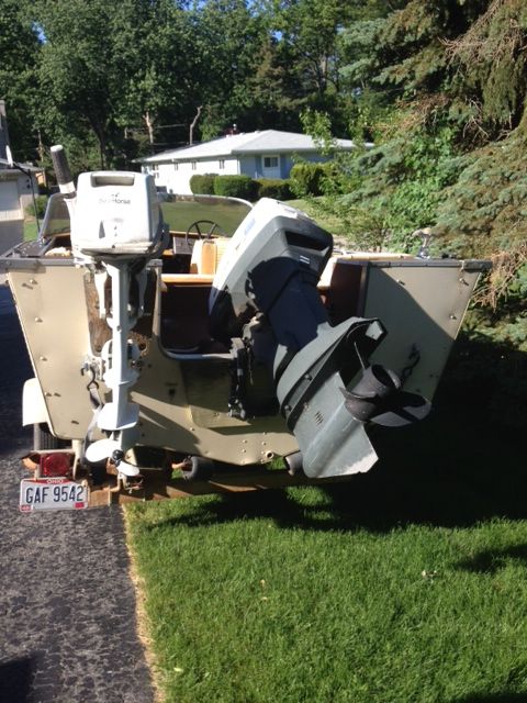

That transom looks deep. I'm assuming that's a long shaft on a 20-21" transom, but it appears to sit so low on the back of the boat. I'll trade you my 15' for your 18' :D

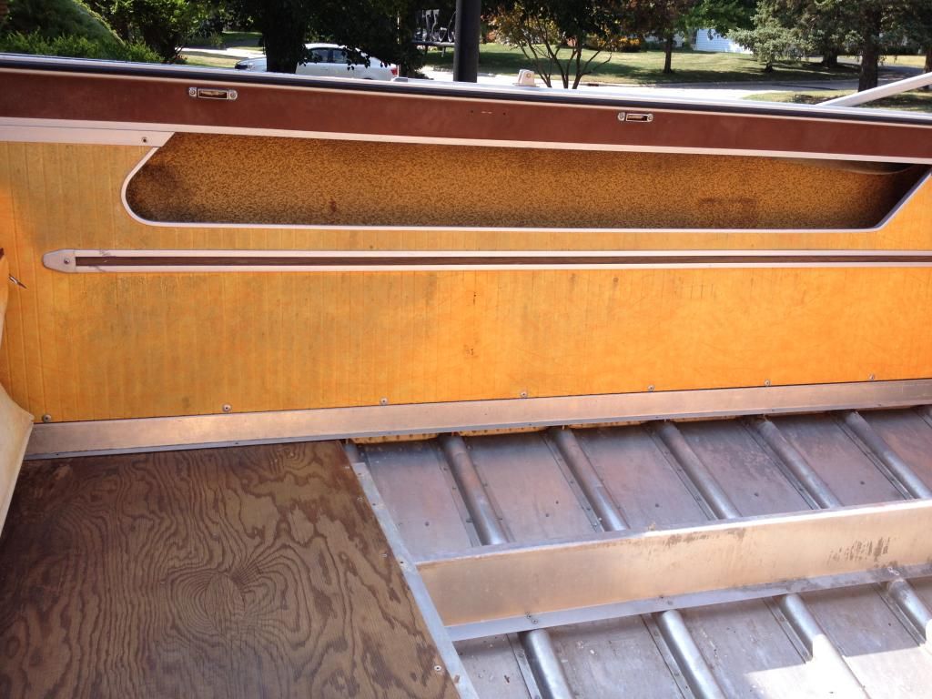

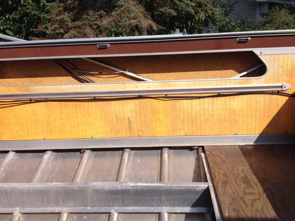

Preparing to replace deck boards but need some suggestions on how to handle faded out and stained side panels. They are solid and would like to avoid removing.
Is this a vinyl type material? Was thinking paint or adhering a marine backed indoor/outdoor carpet. Suggestions and tips appreciated.
delms82
Seaman
Jun 10, 2014
52
Watermann
Jan 12, 2013
13,854
Do you mean replace or remove the side panels? If your Nova is like most of the SC's then I'm not sure how you would be able to remove the decking without removing the side boards since they're screwed down to the deck and there are rivets holding the deck down to the rib ends behind the side panels bottom bracket. The side panels are also an integral part of the boats structure that normally after the years the rivets become loose and need to be replaced. The original material is a type of vinyl fabric that can be easily replaced but I don't know if I would try putting anything over it if it's getting rotten.
