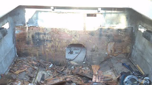

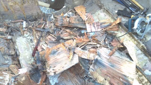

I finished tearing the old transom out. There is still a thin layer of ply on there but it should grind out easily. I didn't want to risk damaging the skin by trying to get it off. Even with all the ply out the transom hardly moves at all, the skin is really thick. I still need to check for straightness but it looks really good so far.
I still have a huge mess to clean up. The garbage man comes tomorrow so I better get back to work!!

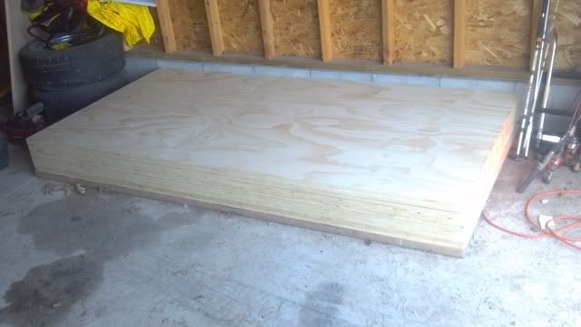

I got the hull all cleaned out again. I still need to pull the rest of the stringers and foam but that should go fairly quickly. I did pick up a bunch of stuff for the boat today. I got 9 sheets of 3/4 Auruco ply, 5 sheets of 1/2 Auruco ply, a few 2x4's so I can add some bunks and I ordered bolster brackets as well. Next week I will be installing the bunks for some added support.
I also picked up two more tyvek suits and another grinder (Dewalt). The Dewalt grinder I have now has outperformed any other grinders I have used so for a little more money I am hopefully saving some headache. It comes with a 3 year warranty so I should be covered there :)
I hope I have enough ply.

Nice materials score...I think you should have just about enough ply to do a solid 99.9% of the Silverline on hand...I just don't know what you are going to use for that last .1%...:rolleyes:...maybe some Teak...or Mahogany...???:confused:???:)

JB, iboats is a one stop shop for everything :D I did put some 2x4's under the stack of ply. I still need to put some weight on top to help flatten out the ones that were a little wavy.

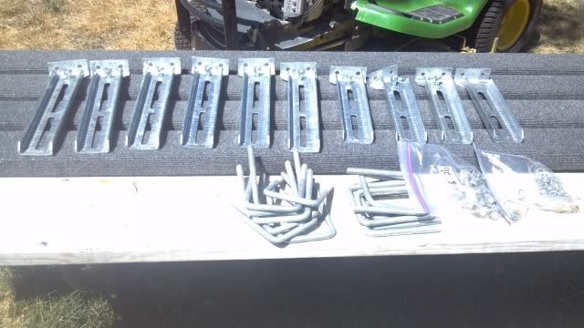

Today my bolster brackets and u bolts came in for the trailer. There were 4 missing and some missing hardware from the box being damaged. I contacted the company I got them from off of ebay and he was going to ship out replacements today. I also got my bunks cut down to size and carpeted. This is going to be alot of work but it will give me reassurance in keeping the hull straight and true.

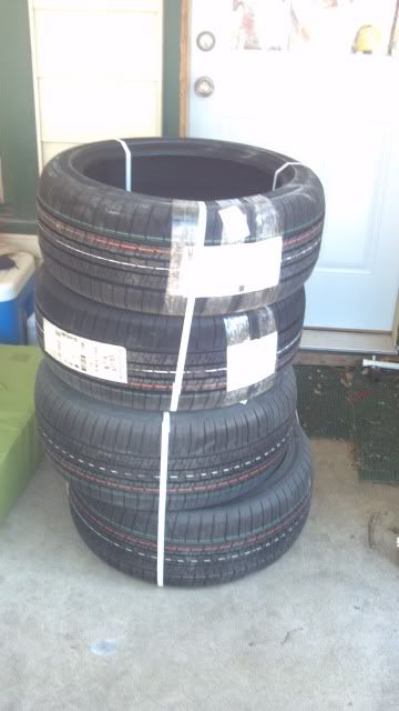

The new shoes for the admirals car came in today to. All I have to say is tires for an 18" wheel are expensive. :eek: Just need to take them in to get mounted up tomorrow.

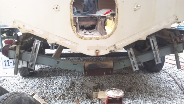

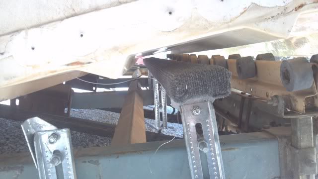

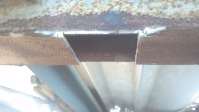

I got two bunks put on today. It was another hot day but laying in the shade of the boat helped :) I had to do a little work on the trailer as there had been some modifications made I had to modify. On the bottom of one of the crossmembers was a piece of flat steel I had to cut out. I'm hoping to have one more put on tomorrow and when I get my other four brackets in the mail I will get the last one put on. I still need to square up all the brackets.
Piece I had to notch out on the crossmember.
The first bunk I set in place. This thing is going to have a ton of support!!

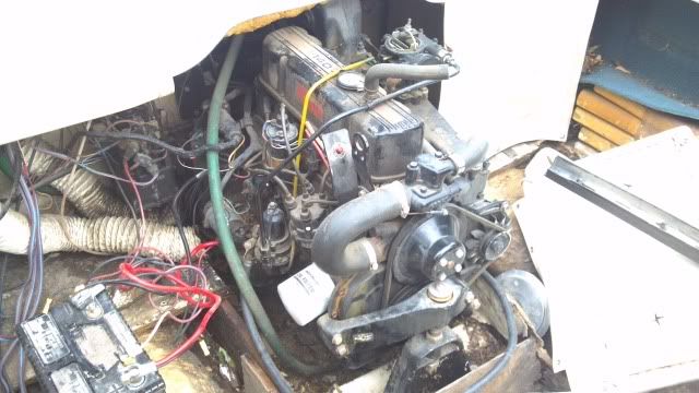

I have been doing some research lately on boats with twin engines. It seems that most boats up to 25' will run 2 140hp 4 cylinders while boats 26' and bigger will run the 165hp inline 6's. I finally convinced myself that this isn't going to be a speedboat. I just like the cool factor of having two legs hanging off the back. I also have to consider weight in with this to.
With that in mind I picked up a donor for $100 today. It doesn't have an outdrive but everything else is there. It was a project that someone started and lost intrest in. Tomorrow I will be pulling the motor, fuel tank and transom components and hauling the boat out to pasture

I did get the one other bunk board put on today. I'm still waiting for my other brackets to come in so I can put the last one on and make final adjustments.
Don't mind the big hole in the back :eek:
