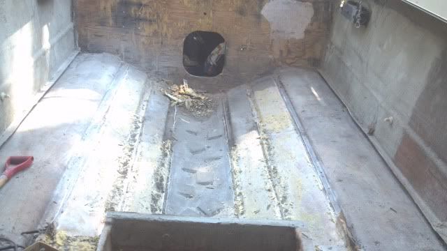

Nice donor! W/ twins, are you still going to be using an under deck tank, just larger?
Larger & moving it forward, can give you some assistance w/ the weight of the twins. At the cost of extra long fuel hoses;)
It originally had two 26 gallon fuel tanks, ne on each side of the motor about a foot infront of the transom. I could probaly move them midship and run the fill on top of the gunwale. I will be putting about the same size tanks back in.
Any way you shake it, two black legs sticking out will be about a million times better than a single white one!
No doubt about that!
That's gonna' be quite the transom project BN. But I'll bet twins will make low speed maneuvering much easier.
It will be a pain to get the new transom in since it's so big. Probably a 2-3 person job.

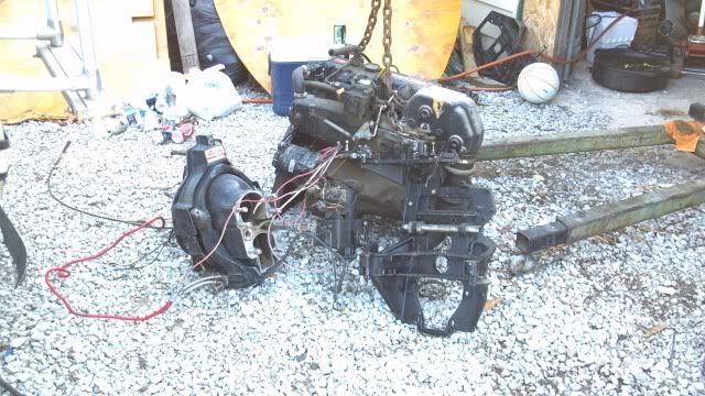

I got the donor stripped out today. I took the steering, wiring, gauges, motor and transom components. It also has an aluminum 16 gallon fuel tank I need to get out still. The filler hose just doesn't want to come out.
I still need to do a compression test on the motor, it ran but not very good. It might be a fuel issue or it might need a valve job.
boatnut74
Aug 29, 2010
1,835
Re: 1972 Silverline Grand Bahama
Did a compression test on the motor. Results are 110, 35, 55, 60. It smokes a little to so I'm thinking the rings are bad. I won't know untill I pull the head. I was planning on freshening up the motors before installation anways so it won't be a lost cause.

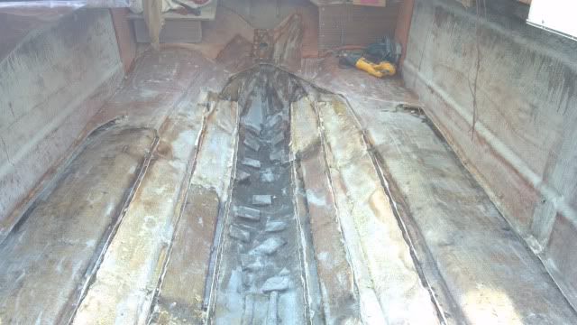

I worked on cutting some of the stringers out this morning. I got about half way done. I still have some foam to pull out and I need to take a few more measurments so I can put this thing back together someday :) The weather has been in the low 60's in the mornings so if this nice weather sticks around I can get the hull ground out in prep for new wood.

Question...the engine you did the compression test on, it's a 4 banger?...I am confused...I thought you were going with a pair of I-6's...:confused:
Oh wait, I think I figured it out...this is the engine that was in there...? right?
boatnut74
Aug 29, 2010
1,835
Re: 1973 Silverline Grand Bahama
I wanted to go with I 6's but I took weight into consideration. The 4 bangers will be lighter and I'm not building a speed boat so they should be sufficient,
The one with low compression is my first donor. I will be freshening the motors anyway so it's no biggie.

I finished removing the foam and stringers today. I'm really excited about this because now I get to start grinding (insert sarcasm here). There is alot of grinding to be done but the forecast for the next week looks good so hopefully I can get a good majority of it done.
