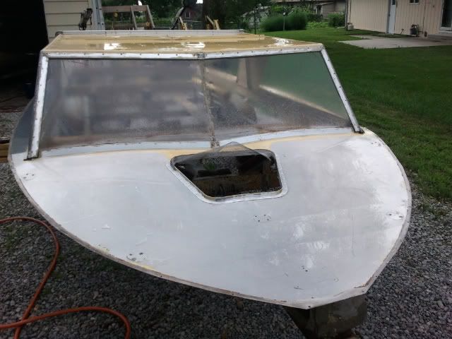

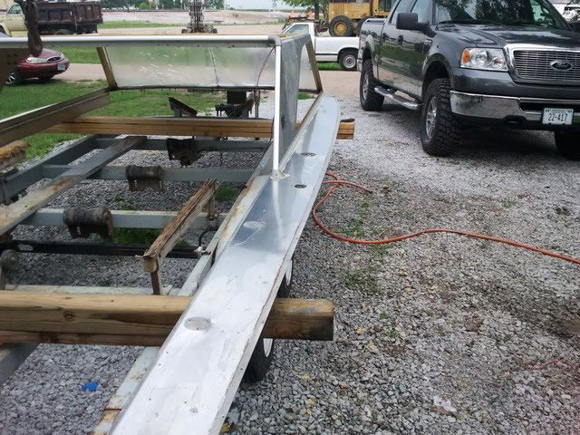

Did a little more stripping today :p. Turned out nice and shiny like the rest but I know how you guys love pictures :D.
Starboard side
Bow

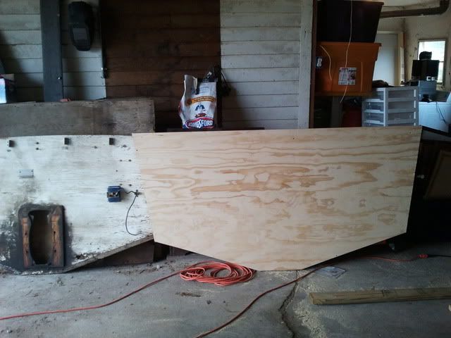

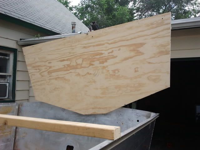

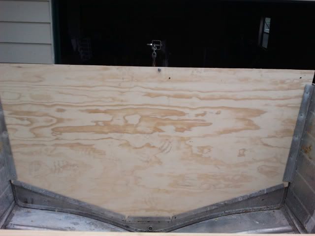

Well I got the new transom cut out and test fitted today!! I'm pretty excited about that. One piece of the puzzle. I still have to laminate the 2 sheets together but I test fit it and it seems ok, a little tight but I think it will work. I'm gonna use Tightbond waterproof glue and then screw the 2 sheets together to pull it tight as the wood isn't perfectly straight. Menards didn't have a very good selection when I picked up the wood.

Nice progress man. That is one big honkin hunk of transom you have there. Funny how similar these hulls look stripped but you can sure tell the difference when you see the transoms. Looks alot bigger without the cut out for the OB as well.

Ya it's one big hunk of wood! I got the 2 pices glued together but I'm not real happy with the results. It doesn't seem to have pulled together as tight as I thought it should. I'll let the glue set up and see what I have. It will be sealed with epoxy so I have no concerns there.

The original plan was to weight it down like that but I didn't have a very flat surface. I put in 30 or so screws, I'll find out weather it holds or not.

I would think once epoxied and all bolted in not much that can happen anyway at least on the O.B. 's like my mariner there are the knee brace bolts, corner bolts, motor bolts, and screws from under splashwell Seems it would be pretty solid after all that.
