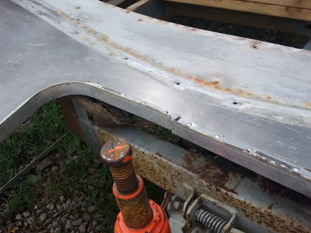

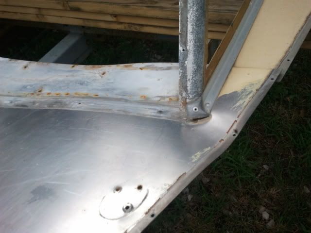

We had some pretty strong storms roll through the area last night. I have my cap sitting on the trailer and the wind picked it up and moved it. I now have a crease on each side of the windshield and a crack by the hatch. Not sure what I'm going to do yet. I'll post some pics here shortly.

This is where it cresed, not sure if I can work it out or not.
This cracked where PO welded it up

Sorry to see that damage but it's all repairable. Having it rewelded should be a snap and if you bring it to a fab shop all cleaned they may not even charge you for such a small job, just be sure to mention what your restoring.

Im not sure what Im going to do yet. The project is on hold right now due to lack of time and money. Time will tell.

Too bad about the damage, I'm not a bodyman but it does look like the creases will be possible to work out, maybe not perfect unless you want to invest a lot of time, and/or money but probably well enough for a 10' boat.

I don't believe the weld is from the PO, mine is like that too and I'm betting it was factory that way.

^^^^^X2 on the weld...Mine is the same.

That's interesting on the weld.
