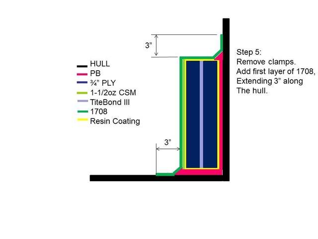

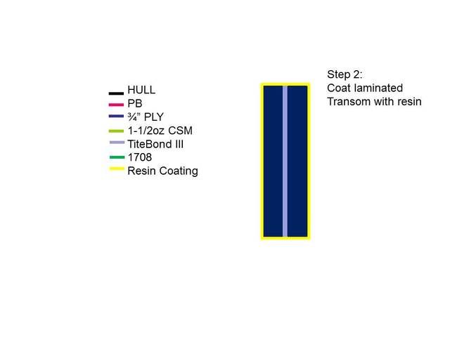

Before i proceed much further, i'd like to get a sanity check of my layup schedule....
here is what i'm thinking:
This is how far i am so far....
Next steps are:
Woodonglass
Dec 29, 2009
25,932
Re: 1973 SRV 220 OV Resto
Two things, 1.) I'd cover the entire transom wood with a layer of CSM prior to Install. Resin is worthless without mat and will crack unless it has fibers to hold it together. 2.) And this is NOT a necessity, just MY OWN personal preference, I drill a dozen 1" holes in the transom to allow air to escape and PB to OOZE into and form a mechanical bond. Learned it form OOPS!
Lastly, Either use a Drill Guide or make your own Drill Bridge from a 2x6 ...
to drill all your holes AFTER the transom is installed. Everything else is absolutely spot on. You should save those drawings and post em in your signature. They're better than mine!!!!:eek:

Thanks for the response...i was going back and forth about covering the entire wood piece in CSM....but you've convinced me to do it.
the 1" holes i'm going to do also.
