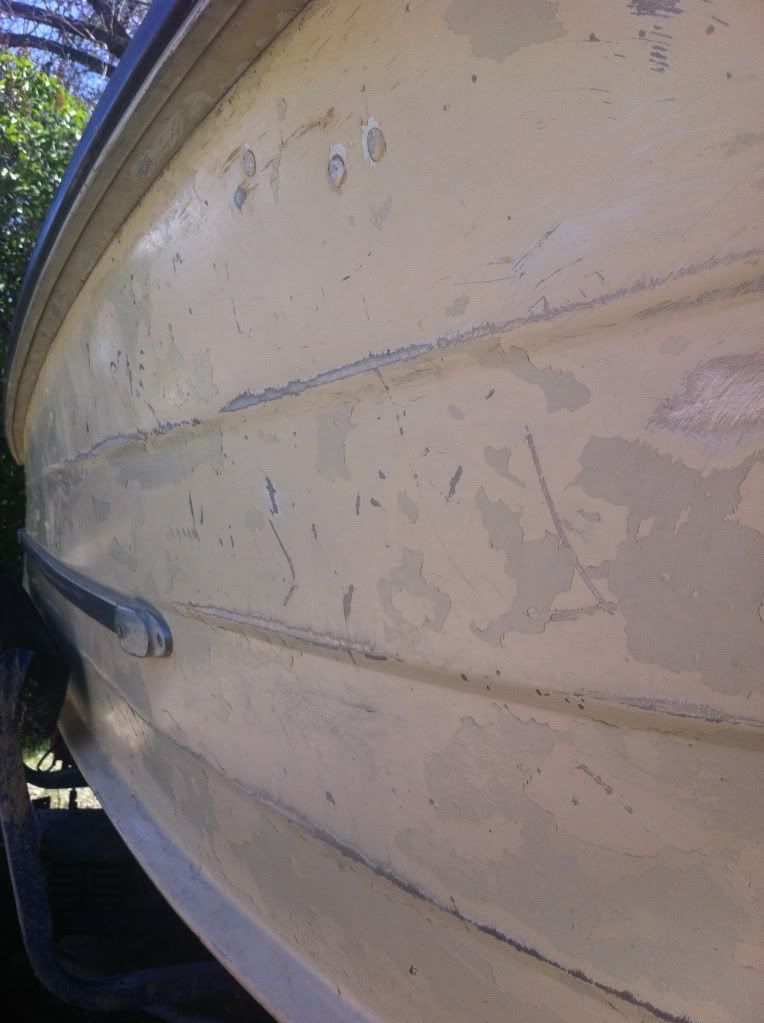

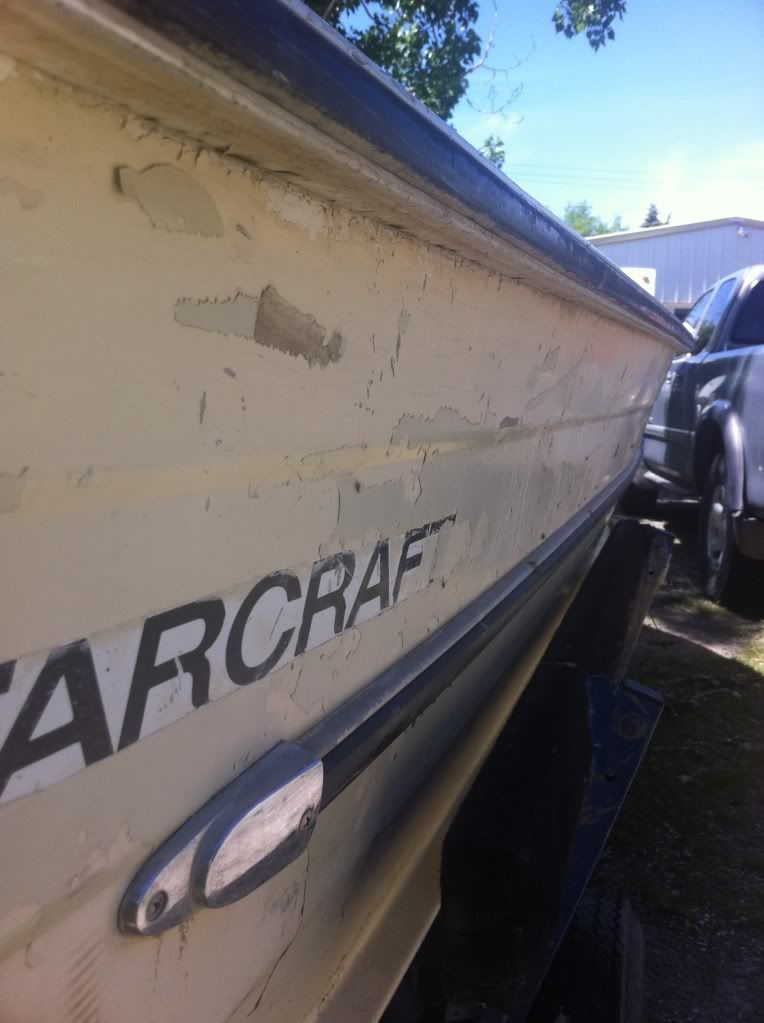

I am going to paint the outside of the hull, but I'm not exactly sure how to go about it. Some forums say NOT to remove the existing paint and others say to strip it all the way off. (Maybe this site had TOO much info!) Heres some pics of the existing paint job, its pretty ****ty to say the least.
I was thinking of ether:
1. Using the same stripper and strip the paint off, then use ZC primer then paint with tractor paint. Or..
2. Sanding the old paint until all the lose chips are gone, then prime bare Alum and paint with tractor paint.
Any suggestions?

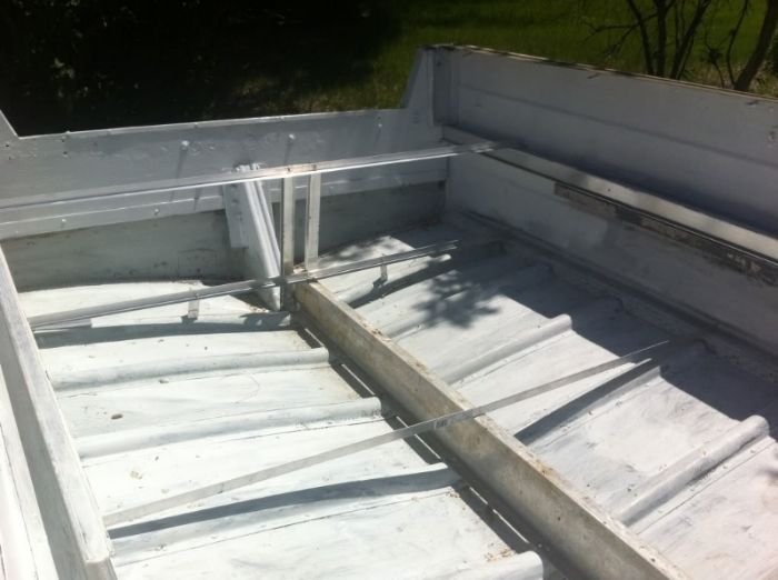

Also here is what I've done so far with the aluminum stringer, there is going to be a rear casting deck and here is the beginning of it.

I wouldn't want that crappy peeling paint under my new paint job, I'd strip it all the way off with the stripper then zinc it and paint it like I wanted.
Some people aren't that concerned with quality, or just don't want to put forth the effort to completely strip a boat with a really crappy paint job.
If your old paint job was mainly sound with just a couple/few little peely/blister spots I'd say just sand it, but the paint job you're dealing with is complete junk and should be treated as such.

One issue I ran into was: the top of the center stringer isn't level with the indentation on the sides of the boat. (where the edges of the plywood go) The stringer is about 1/4" too short, I was thinking I would use some aluminum flat bar as "shims" to make it level. Is there anything wrong with that?

The center stringer isn't that big of a deal and you can shim up with aluminum bar stock like you mentioned.
