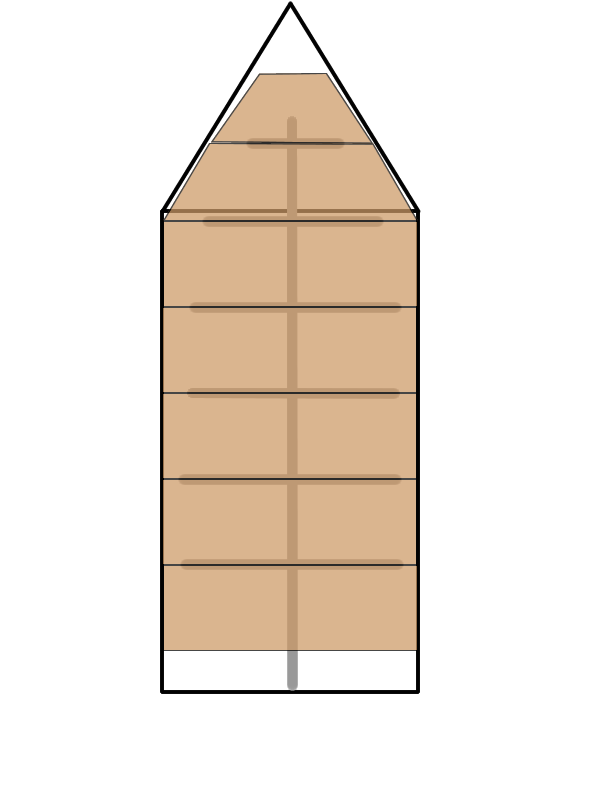

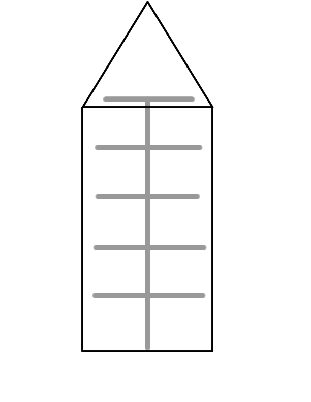

Alright do you guys think this is a good idea? Here is the aluminum stringer design. The middle peice would be the Z channel that I still have.
and if I understand it correctly this would be how I would lay out the deck...
thanks for all the help I really do appericate it!!!

Re: 1973 Starcraft 15.5ft unknown model AMBITIOUS restoration
Bud you really dont need all those stringers....
the width of the plywood sheets determine how many there is going to be, correct?
Right. Unless your boat is less than 4' wide you will need the strips (or stringers if you choose) every 4' so they occur at each seam in the plywood.
With my 14 footer, there were stringers at each joint int he plywood. They are so thin that the only function they could serve is to keep the joint tight and maybe resist warping. In my boat the original joints were under the seats which were screwed to the plywood. They would have kept the plywood stable by themselves so I really don't know what good the stringers did. My original floor was made from plywood wider than 4 feet so they only had three pieces (two joints). My new plywood was 4 feet wide so I added a joint to the center section. it lined up with the live well and the storage compartment forward of the console so the screws from those attachments would have kept it stable by themselves. However, since I didn't know what the real purpose of the thin stringers was, and I had some thin aluminum sheets hanging around, I made a stringer for my new joint. My boat had no foam under the deck. The only floatation was in the seats and in void spaces behind the storage compartments and the live well. I replaced some of that (rodent nests) and stuffed the extra under the new floor. The foam does not support the floor, the ribs attachments and the centerline Z section are all that supports it. It's very stiff.
For what it's worth, there is a wide variety of opinions about sealing the floor. You'll see everything from epoxy resin to paint. My boat was mostly stored outside under a tarp and the floor lasted 24 years. The original floor was not sealed at all. It just had a vinyl non-skid covering on the top side. I chose to paint the underside of my new deck and cover all the edges and the top with Grizzly Grip non-skid coating. I figured that if the original floor lasted 24 years without any sealant, epoxy was overkill particularly since the boat is now inside my garage. A boat that's kept outside in the weather might be a different story.
The strips are to hold down the edges of the plywood and to tie the center stringer/plywood/edge of the deck together. And for the record I used marine grade douglass fir plywood and glassed it. But as said above, there are many approaches you cant take.

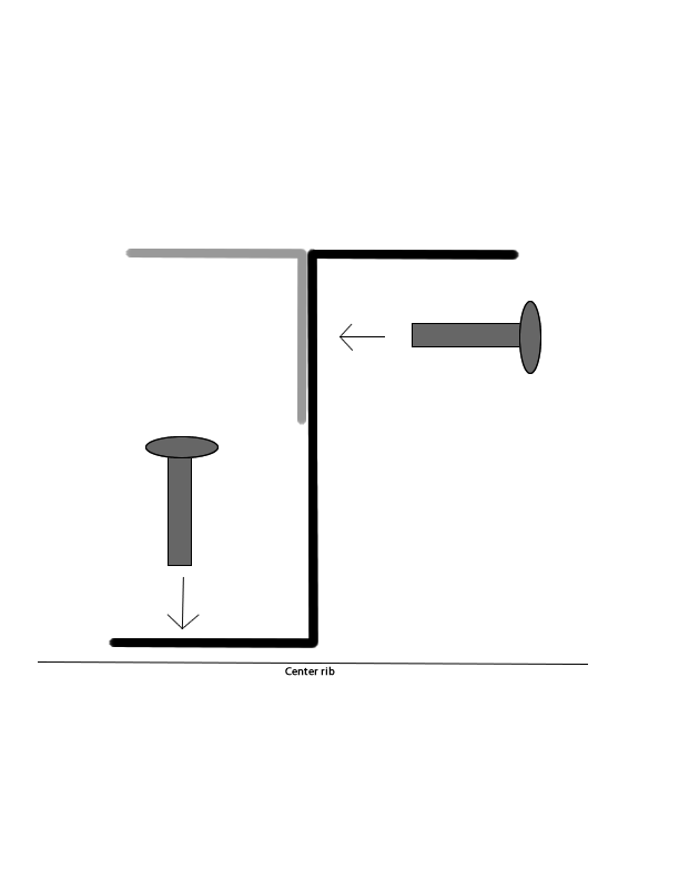

Wow I don't know where I'd be without all this help... So I have ordered a rivet gun off amazon and I assume I can get rivets at the local hardware store. Once again I have a million questions, so I'll try to limit it to a couple.
1. I looked for aluminum last time I was in Home Deopt with no luck, where should I go to get aluminum angles and whatnot?
2. Is there a typical size rivet that everyone is using? I assume I'll just get SS rivets thats aren't too long.
Here is what I am thinking so far. I attach an aluminum angle to the Z-Channel to get a flatter surface. Something like this:
Should the strips be aluminum angle? or square aluminum? or what?

The size, especially the length of the rivet you need is determined by what you are fastening together, the length (grip range) being the most critical. In your case you should use aluminum rivets with aluminum shanks. You probably want 3/16" diameter.
Home Depot usually has their metal tucked away somewhere in or near the hardware dept. If you have a Lowe's near you, I've found that they have a better selection. Tractor Supply Store also has some, but here anyway, their selection isn't as good as the other two.

Scrap yards and recycle centers are the best places to go for aluminum, they sell it for a fraction of the coast at Home Depot.
Lakelover is right about the length of the rivets, you should purchase your angle first before buying rivets. I'd go for the .063 (1/16") thick angle and the grip range of your rivets should be .126 - .250. I prefer the closed end aluminum blind rivets with the steel mandrel because they're the strongest, and I doubt your hardware store will have these... but you can buy them online here:
http://www.rivetsonline.com/rivets-en/blind-rivets-en/closed-end-blind-rivets.html
The PR64ASPH are the ones you want.
Your drawing is perfect for what you want to do. What program are you using to make drawings like that?

I don't know for sure how your Z section and the aluminum stringers were arranged before your demolition job but they didn't look like your drawing in my 14 footer. In my boat, the Z section runs fore-aft and is riveted through the bottom into the tops of each rib. From the pictures you posted, the Z section is also fore-aft and I can see the holes in the top of the ribs along the centerline where it was attached so I think your boat is put together just like mine. I don't have anything that I'd call a "center rib" as you've labeled in your sketch but if you meant the center of the rib, then the orientation of the Z section is fine. The stringer is going the wrong way though. My stringers run port to starboard, not parallel to the top of the Z section. They weren't riveted to the Z section other than as part of a sandwich where the floor covered the stringer and there was a rivet down through the floor. I'm not good with any drawing program but I've attached a couple pictures of my boat during demolition (note the 24 years of crud on the bottom) showing the Z section layout and the two stringers. The first picture is of the aft end looking starboard, and only the aft most floor section is removed. You can see the end of the Z section and half of the stringer (the other half is still under the next floor section) on the left side of the picture. The rivet hole at the end of the Z section is from a floor attachment rivet. There are no rivets going through the vertical part of the Z section. The second picture is with the floor all out looking forward. The forward stringer is still in but this part of the picture is kind of dark (sorry), but you'll get the idea.
The stringers on my boat were thin aluminum plates, about 4" wide by about 4' long and are riveted to each edge of the floor panels they joined. Unfortunately, I've never seen this kind of material in your normal hardware stores or HD or Lowes. You could use thin angle sections, but you'll have to break the stringer where it meets the Z section and you'll have to make it short enough (or taper it) so that it doesn't interfere with the ribs out toward the edge of your floor. I happened to have a couple scrap pieces from an old project laying around that were thin and flat so I used them for the new joint I added to my floor. To be honest, I think the stringers could be made from wood as long as you sealed the stringers too, but you'd still have to have a break where they crossed the Z section. I don't think that's a problem though since they just join the floor sections and don't provide any strength.
Good luck, 1988 Starcraft

Ok thanks for the input. I've been contemplating different ways to do the cross strips out of aluminum and the best idea I have came up with is to use this:
http://www.onlinemetals.com/merchant.cfm?pid=1130&step=4&showunits=inches&id=997&top_cat=60
Its essentially an aluminum board, 1/8" thick and 3" wide. I would rivet these to the Z channel. Then I could rivet the plywood to the aluminum flat pieces. What do you guys think?

1988 Starcraft again. The aluminum bars you choose will work fine. A few things you need to think about in advance. If .125" thick is as thin as you can find (Try a sheet metal,HVAC shop. That's where I got my thin aluminum sheet pieces. They may even have it as scrap) you probably don't want (or need) a continuous stringer that goes over the Z section. Using the .125" bars would give you a spot in the middle of your floor where there was a .125" bump. Just attach a stringer to the floor on either side of the Z section and it will still keep the plywood in place. The wood itself will need a rivet to the Z section at the end of the section anyway so the whole thing will still be fixed together. My opinion is that the stringers add no strength (at least the really thin ones in my boat certainly don't) and at most just serve as an alignment and anti-warping function so if they're not directly attached to the Z section it doesn't matter. If you use the .125" aluminum bars, you might want to buy some longer grip range rivets to make sure you can go through the aluminum, the plywood and whatever floor covering you apply. Mine went up to .625" but that would not leave you much extra if you use 7/16" plywood which was what my original (and new) floor uses.
As far as a construction sequence goes, Whether you find thin stringers and want to have them go over the Z section or not, don't rivet them to the Z section first. Start at an end floor section and attach the aluminum stringer(s) to it off hull first. Off hull it's easy to use clamps to keep the stringer where you want it and easier to drill through both at once. Tack that floor section into the boat with a few rivets to keep it in place (you can finish riveting it in after you're sure you've got it aligned right and everything fits perfect). Then install the next stringer (or pair of stringers) on the adjoining floor section (again off hull), align the second floor section, and tack it in place. That way it will be easier to get the stringers nice and square and you'll be able to drill through both the plywood and the aluminum stringer in one shot to attach the adjoining floor sections. Work your way forward (or aft) this way and you should be able to get everything aligned and drilled cleanly with minimum hassle. I used basically this sequence in my 14 footer and had no problems installing the floor. That job took about 4 hours with no help.
