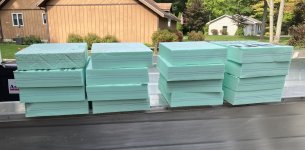

piperjoe
Jul 11, 2013
613
Preparing the floatation foam pieces so we can lay them between the flooring rails. It sure is a nice day to be outdoors.
Safe boating,
Joe
