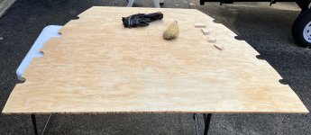

The Admiral and I applied the first West Systems epoxy coat to the bottom of the recently cut out front deck piece, and, to the bottom of the small deck piece that fits right at the bow. Also found the aluminum deck strap that connects these two deck pieces so I will get it cleaned up and ready to install. Tomorrow looks like a good day for applying the second epoxy coat to the deck pieces and getting the floatation foam placed into final position within the bow area…then it’s rivet time again! 🙂
Safe boating,
Joe

Second brushed on coat of West Systems epoxy is on the bottom surface of the above two decking pieces and curing. Removed the rivets from the forward decking strap. Thought the task would take a few minutes…not. Anyway, if it’s not raining tomorrow we’ll have a go at getting the two pieces of decking riveted to the boat. Onward we go!
Nope! Just thought of a question. After I fill the countersink holes in the new decking with 5200, how long should I wait before applying the spar varnish to the topside surface of the deck?
Safe boating,
Joe

Gibbles
Nov 14, 2009
2,046
I would say give it a solid week to ensure you have a full cure of that west system epoxy.
that varnish will also take forever to cure.
West system cured pretty quickly for me in general.
I used the fast cure during the winter, and the slow cure in the summer.
In the summer, even the slow cure does not like sunlight during curing.
Stuff reacts fast when it gets hot!
I also used a small heater to keep the piece warm, it helps that my garage door is insulated and has weather seals to keep the draft out.
