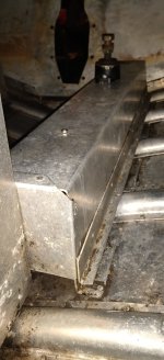

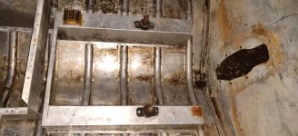

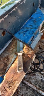

The V8 sits right on two boxed beams, open only at rear, with nice reinforcement plates that extend down between the ribs. I have discovered that this is not the only structure however and there is a wood piece about 4x4x36 (estimated) secured underneath the aluminum beam, located in place by 2 studs with stainless steel nuts fore and aft. The motor mounts then bolt through the beam and presumably screw down into the 4x4. I am going to test the integrity of this piece of wood once the transom is completely out and I will add more detail. Here are a few pictures of it for now:

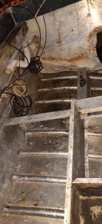

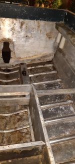

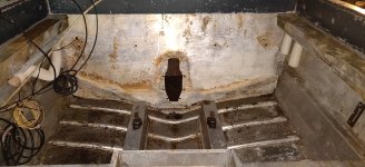

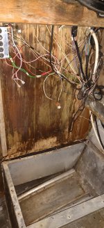

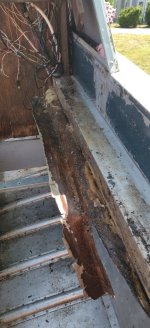

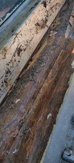

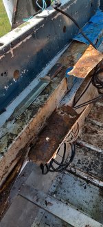

Today's progress:
Extensive pressure washing of transom and hull interior along with removal of non-OG 20 gallon stainless port side tank and hidden rotten wood behind it.

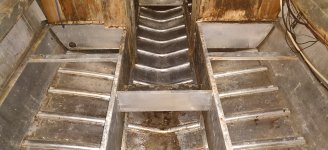

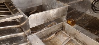

Anyone have pictures of what the factory (or DIY) hull reinforcements look like on these Chieftains??
I know that they added some sort of rib end support on some later hulls and was wondering just how those were attached. This hull appears to have a structural beam each side that connects the gunwales and the hull bottom in addition to its normal riveted seam. This looks as though it is to reinforce the spray chine and rib end connection. So not sure if my hull already has the extra reinforcement or not.
