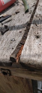

While all the ceiling is out I took some pictures of how the windshield appears to be attached by a row of rivets for its leading two edges and a single stainless screw through the aluminum at each rear corner. Not sure if the rivets hold the actual windshield frame itself down or maybe a track that the frame slides onto or something.IMG_20230629_225258__01__01.jpgIMG_20230629_225338.jpgIMG_20230629_225345.jpgIMG_20230629_225351.jpg

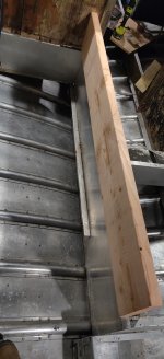

And finally- the build begins. Decided to go with 2x10's as a cheap simple solution to quickly and securely raise cockpit deck height while also boxing in the mammoth tanks. This layout will have the tanks nice and low on hull for stability. Putting in a 2' by about 5' piece of 3/4 down each side to bed the tanks. Wish I had the time and money to go all aluminum or fully seal all the wood but necessity calls for an expedited build. All the timber so far is fir so should last a while hopefully. Planning to keep her covered as much as possible. In any case, so glad to finally be constructing instead of destructing. More pictures will follow as the cockpit takes shape.IMG_20230629_140911.jpgIMG_20230630_185004.jpgIMG_20230629_204605.jpgIMG_20230630_185018.jpgIMG_20230630_213824.jpgIMG_20230630_185351.jpgIMG_20230630_213808.jpgIMG_20230630_180747.jpgIMG_20230630_225650.jpgIMG_20230630_225631.jpg

Looks good, that will make for a nice platform and walkway. If unsealed, make it easy on yourself to get to so you can seal it. Once covered up in a marine environment it will definitely mold, even though it will probably take many years to actually rot. Even one coat of anything to seal it would be better than nothing.

Thanks, and you're definitely right. I am planning to paint it as I go along, just not yet. Hoping to get it mostly cut and fit together then paint as much as I can. Mold definitely sucks big time so probably will use some Kilz or something on it in subfloor areas. Hoping to rig up some kind of passive solar powered bilge and subfloor vent (in addition to the ones that get switched on before starting) eventually for it to help keep the boat's wood and styrofoam and whatnot drier down there.
