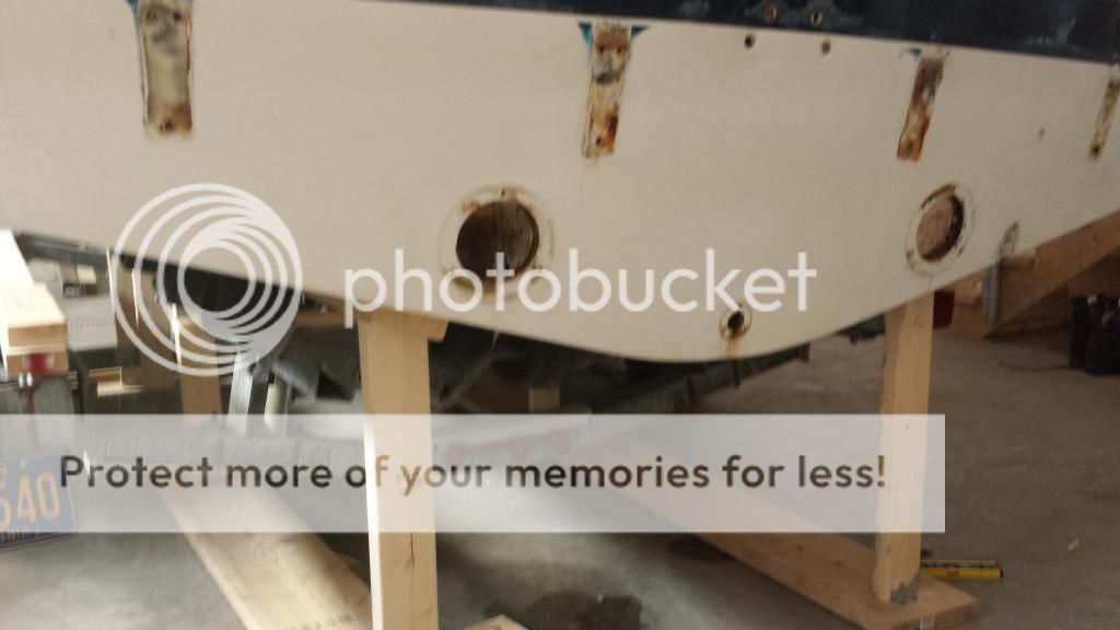

So ive been doing alot of reading, I found this photo by "89resorter " rebuilding his old ski boat............... Is this what i need to do to support everything before tearing her apart? if so, this wouldnt be the end of the world i could do something like this fairly easy, im just rather curious if he's actually got the boat sitting OFF of the rollers at all, or if their just high enough so that the boat is resting on them, but not jacking the boat.
89 resorter
Oct 3, 2013
287
Derekxj, the pic you show of the support structure under my boat was not quite completed at that point and I ended up also placing bunks along the trailer frame to provide a total of 4 bunks. You can see the beginning of the port side bunk at the far left of the picture. Basically, I got them as tight as I could by eye then used shims to tighten them up to the hull. It did not lift the hull from the rollers but it did provide for sufficient support. I recently got done grinding the entire inside of the hull and have not seen (or felt) any flexing so I am considering it a proven design.
Best of luck.

Yup, that's the idea. Build it so it's nice and tight against the hull, and then maybe drive some wedges under the feet for just a bit more added support!!!;)
Best of luck.
Thanks alot man. nice work!! Do you have any photo's that show the whole support setup ? This stinks in a way because it sounds like god forbid i need to move the boat to a different location prior to her being completely done.......deck stringers and transom........things are going to get FUBAR'D quite quickly.
