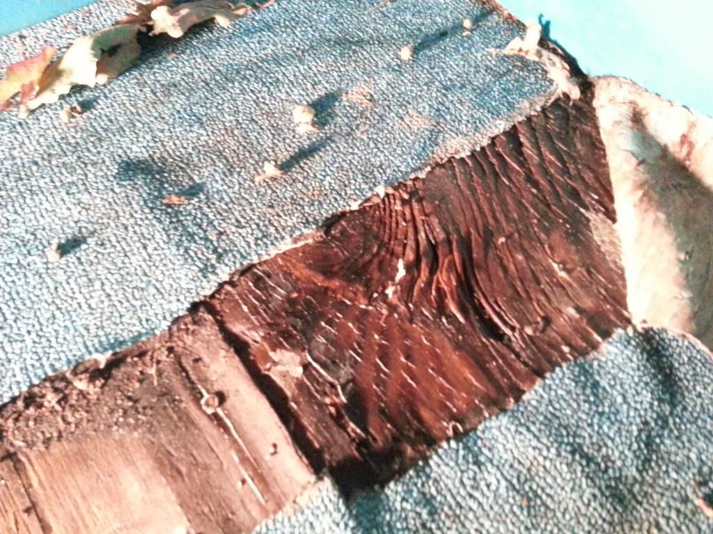

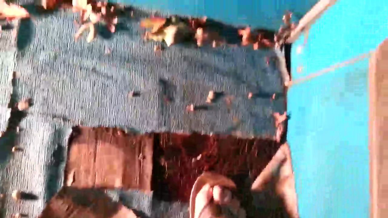

Anyway........I got balsy and ripped up a piece of the garbage plastic flooring junk in the worst soft spot on the deck. what i found........was a bit alarming. It was the consistancy of wet balsa wood. Ugh! What the heck am i getting myself into?????? Quick picture and a video showing exactly how soft it is......
All of that is typical.
The decking in the pic isn't original, that's some CDX crap someone put down.
As we've been trying to tell you, your boat is nasty and rotted. This will make the demolition easier than if it was just partially rotten.
Wear a dust mask or respirator when removing that rotten stuff from your boat, there's all kinds of mold and mildew spores in there that will cause respiratory problems similar to a cold or the flu. Gloves won't hurt either.

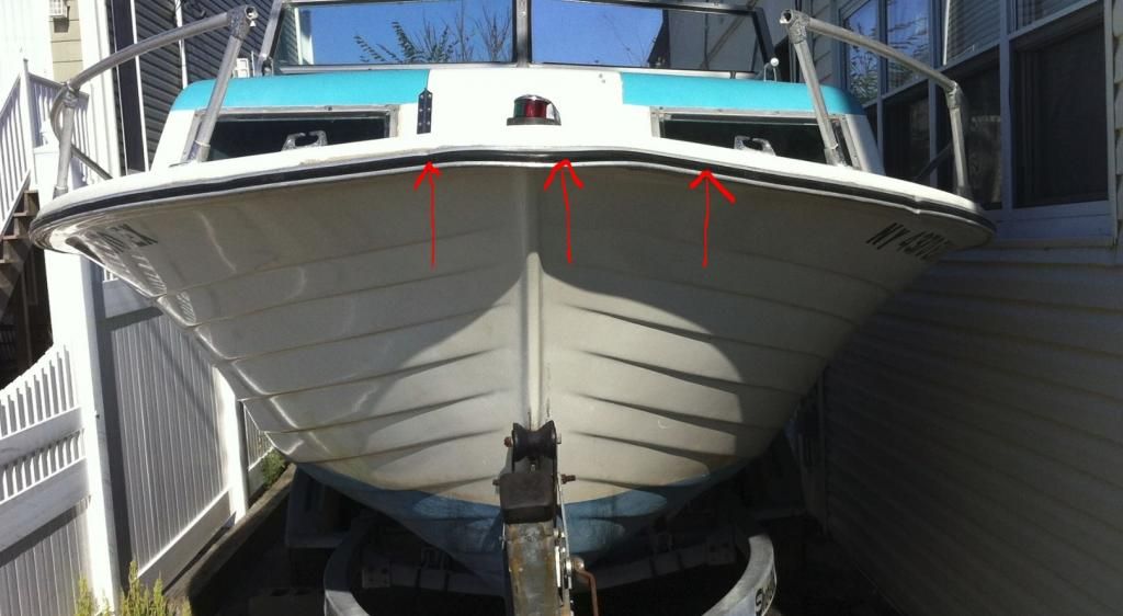

What to do about the front cap and the obvious dock damage it encountered at the rub rail level?
As i said if i stand at the bow on my driveway, and push up UNDER the lip of the rub rail.......its almost as if the top side seperates from the lower portion of the hull right at this point. I can seperate it i would say, as much as about a 1/4 inch with little effort, as much as maybe an inch with alot of effort. see attached picture i drew arrows at the points where i can feel the top part seperate a little bit.
Eddie griswold also gooped up about an entire tube's worth of silicone under the rub rail in this spot.

We see a lot of Cousin Eddies work come through this forum and he's been named the "Typical Previous Owner".
The bow work will be mainly cosmetic and should be left until after the structural is done and you start making her pretty again after you give her some new "bones".
You'll probably end up separating the cap from the hull in that area and re-doing the crunched fiberglass... it'll be a piddly task compared to the transom, stringers, and decking.
